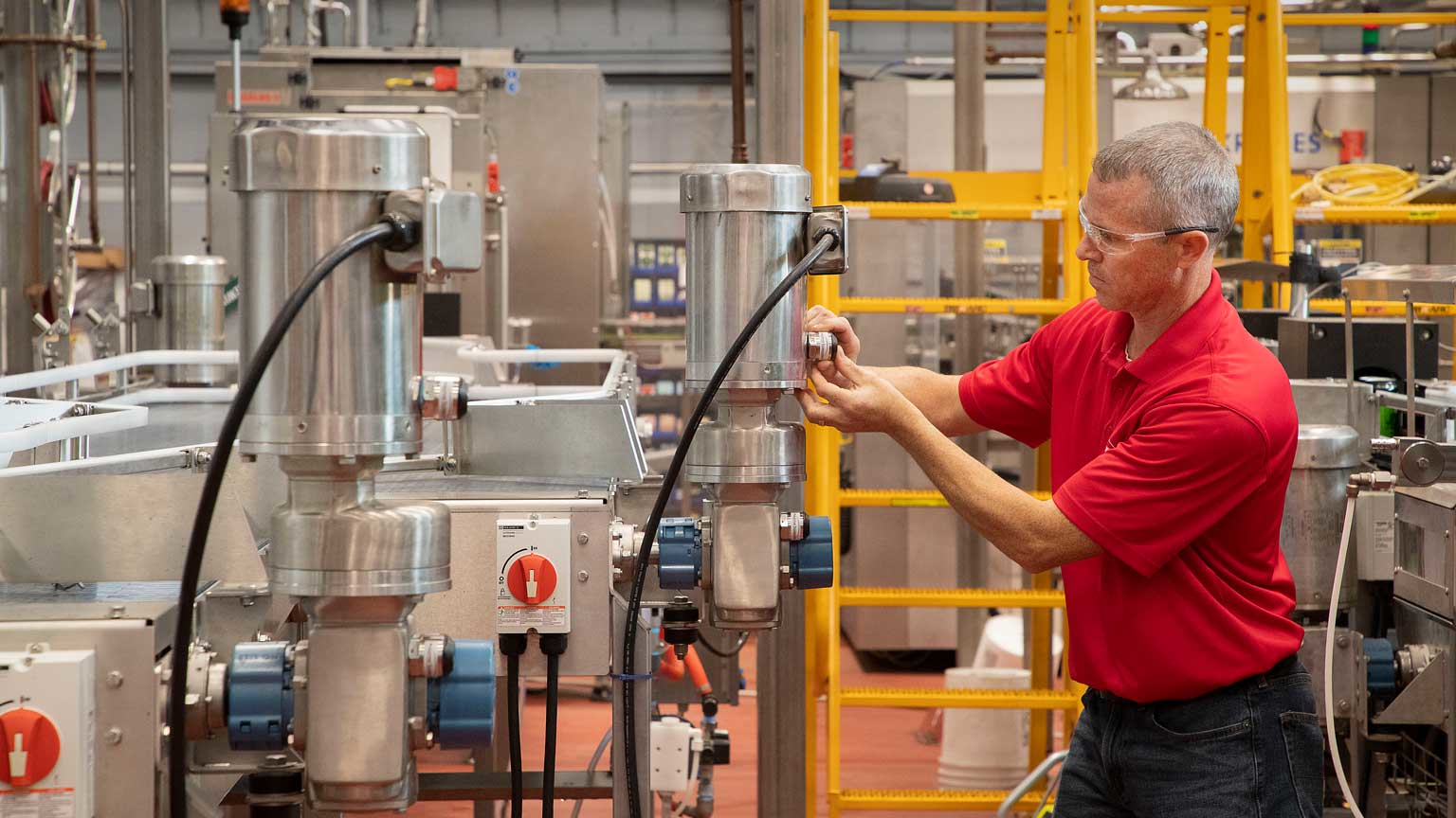

Likewise, inventory audits should identify what’s important to know about each piece of equipment. Vibration monitoring sensors can detect micro fractures, but does the company need that for a small-horsepower conveyor motor? It may only need to monitor the motor’s temperature and then alert technicians when it exceeds a certain range. Then they will know it’s time to change out the motor.
IoT technologies can monitor equipment vibration, temperature, belt speed, lubricant and motor current. The resulting real-time or near-real-time data and insights they generate can be used to streamline processes and provide unprecedented access to engineering and design information. They also can help in training, installation, repair and support services, all of which adds up to new capabilities to avoid disruptions to operations and related costs.
