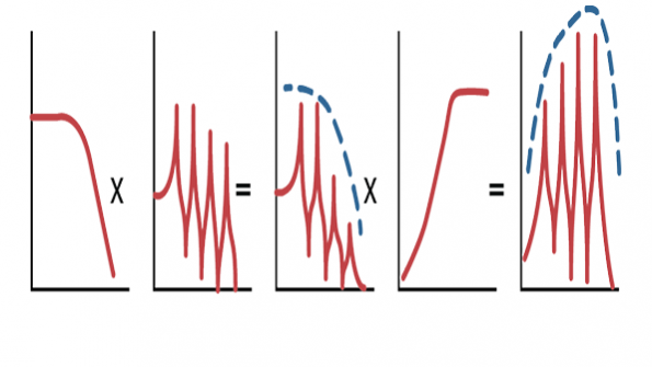

The factors that influence noise generation are summarized in Figure 1 (below). Unfortunately, people often reference only input excitation (force) and sound pressure or sound power. They tend to avoid the other factors that make up the physics of noise generation. Sometimes one part is dominant while others are not. Therefore, one must consider all of these factors when designing for low noise.
Furthermore, the process applies separately to airborne, fluid-borne, and structure-borne noise. Each application is unique, so you can’t assume that what works in one system or assembly will work in another.

Structure-borne noise is the result of vibration transmitted only through the structure of the application. The vibration, as shown in Figure 1 above, is the combination of the force and the response of the component, and the radiation efficiency of the component. These structures then emit an audible sound, or airborne noise, which is what hydraulic equipment operators physically notice.
