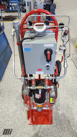

VFD use continues to grow in the OEM space for small and mobile equipment, which needs to be plugged into a single-phase outlet or in a commercial setting where three-phase power is less accessible. Examples include mobile pumping units, hose crimpers, lifts, actuator-driven devices, fans/blowers or any application where a motor is the prime mover and varying that motor’s speed would improve that equipment’s operation. Aside from the benefits of variable speed control, this increased use is driven by VFDs' ability to use a single-phase power source while outputting a three-phase, current-controlled supply to the motor.
