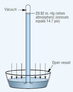

Atmospheric pressure is measured with a barometer. A barometer consists of an evacuated vertical tube with its top end closed and bottom end resting in a container of mercury that’s open to the atmosphere. The pressure exerted by the atmosphere acts on the exposed surface of the liquid to force mercury up into the tube. Sea-level atmospheric pressure will support a mercury column generally not more than 29.92 in. high. Thus, the standard for atmospheric pressure at sea level is 29.92 in.-Hg, which translates to an absolute pressure (psia) of 14.69 psia.
The two basic reference points in all of these measurements are standard atmospheric pressure and a perfect vacuum. At atmospheric pressure, the value 0 in.-Hg equals roughly14.7 psia. At the opposite reference point, 0 psia, otherwise known as a perfect vacuum (if it could be attained), would have a value equal to the other extreme of its range, 29.92 in.-Hg. However, calculating work forces or changes in vacuum-system volume requires conversions to psia or negative gauge pressure (psig).

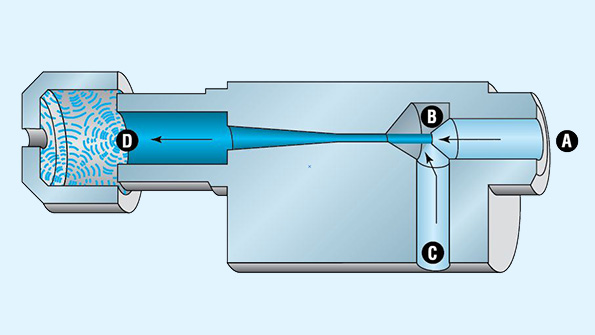

Vacuum generators operate on the venturi principle. Filtered, non-lubricated compressed air enters through inlet A. A diffuser orifice (nozzle), B, causes the air stream to increase in velocity, thereby lowering its pressure and subsequently creating a vacuum in channel C. The air stream exhausts to atmosphere through muffler D.
Due to the compact and lightweight nature of vacuum generators, they often can be mounted at or near the point of use. They’re inexpensive, and because they have no moving parts, maintenance pales in comparison with mechanical vacuum pumps. They don’t need a prime mover because they generate vacuum by tapping into an existing compressed air system. However, retrofitting the generator into a machine may require increasing the capacity of the existing pneumatic system. Heat generation, often a limiting factor with mechanical vacuum pumps, is of little concern with vacuum generators.
