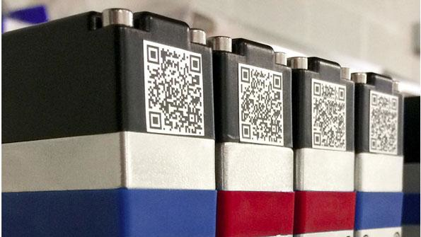

Unconventional Pneumatic Technology
Proprietary solenoid valve technology from Nexmatix recycles an average of 30% of the air otherwise exhausted to the atmosphere, thus reducing air consumption without compromising actuator function. The valves are a plug-and-play replacement for standard off-the-shelf ISO valves typically used for controlling air cylinders.  Reducing the air consumption results in lower electricity and compressor maintenance costs. The technology can be applied to most popular 5-port/3-position and 5-port/2-position valve lines with negligible cost difference.
The technology works by briefly connecting the valve’s two cylinder (outlet) ports during each stroke. As the valve cycles, the pressurized cylinder port connects to the opposing (unpressurized) cylinder port, recycling the compressed air from one end of the cylinder to the other. This effectively precharges the depressurized end before it is connected to supply, saving on average 20% to 40% of the compressed air.
The two ends in fluid communication are allowed to briefly dwell (equalize) before venting the remaining spent air from the first cylinder port. This connection occurs on the order of tens of milliseconds and is transparent to the user. For a three-position valve, typical center-position behavior is maintained during power down or loss of pressure.
