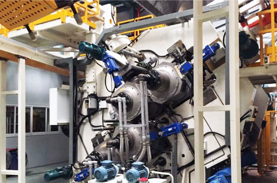

JiangYin QinLi makes machines with two-, three-, or four-roller calendering. Two-roller machines are often tasked with processing raw material while three- and four-roller versions process final products.
With Wuxi Forever’s guidance, the company installed synchronous serial interface (SSI) position transducers (MDTs) from MTS and Wuxi Forever, and pressure sensors from Gefran. On a new two-roller extrusion machine, it added an RMC75E electrohydraulic motion controller with two-axis MA2 and AP2 expansion modules from Delta Computer Systems. Their new four-roller machine uses a eight-axis Delta RMC151E with S2, H1 and U I/O modules to press either rubber or fiber films.

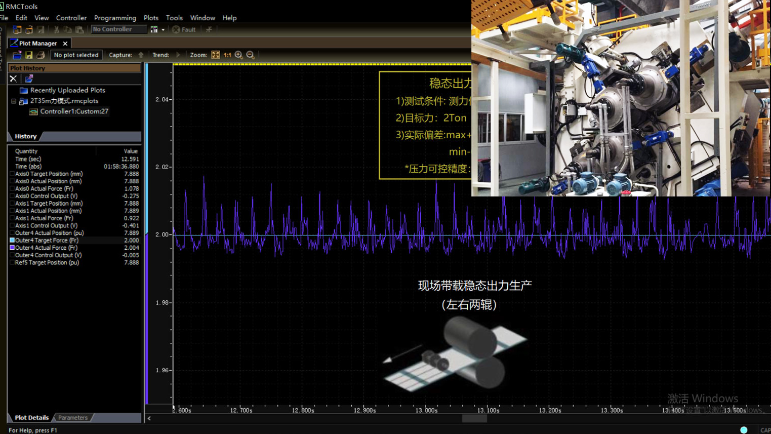

The Design team chose Delta controllers based on their experience with ones that sequenced more smoothly between pressure and position control than other controllers. Many motion controllers suffer a position jump when transitioning between control modes (force versus position), and this deforms the calendered product. Delta controllers showed no such bounce. Additionally, Delta provided advanced control algorithms, including those using high-order gains to control the cylinder acceleration, as well as cylinder position and velocity. JiangYin QinLi engineers found it straightforward to use the RMCTools that came with the controller to create new algorithms.
The controller’s built-in programming commands let the devices easily handle dual-loop control in which pressure is monitored while position is being controlled. The dual-loop control also makes smooth transitions between position/velocity and pressure/force modes. The Delta’s integrated protocols facilitate seamless communication between the RMC and connected transducers, PC/PLCs and valves.
“These RMC advantages are critical for solving ever-present calendering issues such as cylinder synchronization and reducing oscillations when pressing layers thinner than 50 to 70 µm,” notes JiangYin QinLi’s chief engineer YeGang Zhou. “The Delta controllers maintain synchronization to within a margin of ±0.003 mm for cylinders without loads. They also provide the responsiveness needed for quick, critical adjustments to load changes.”
