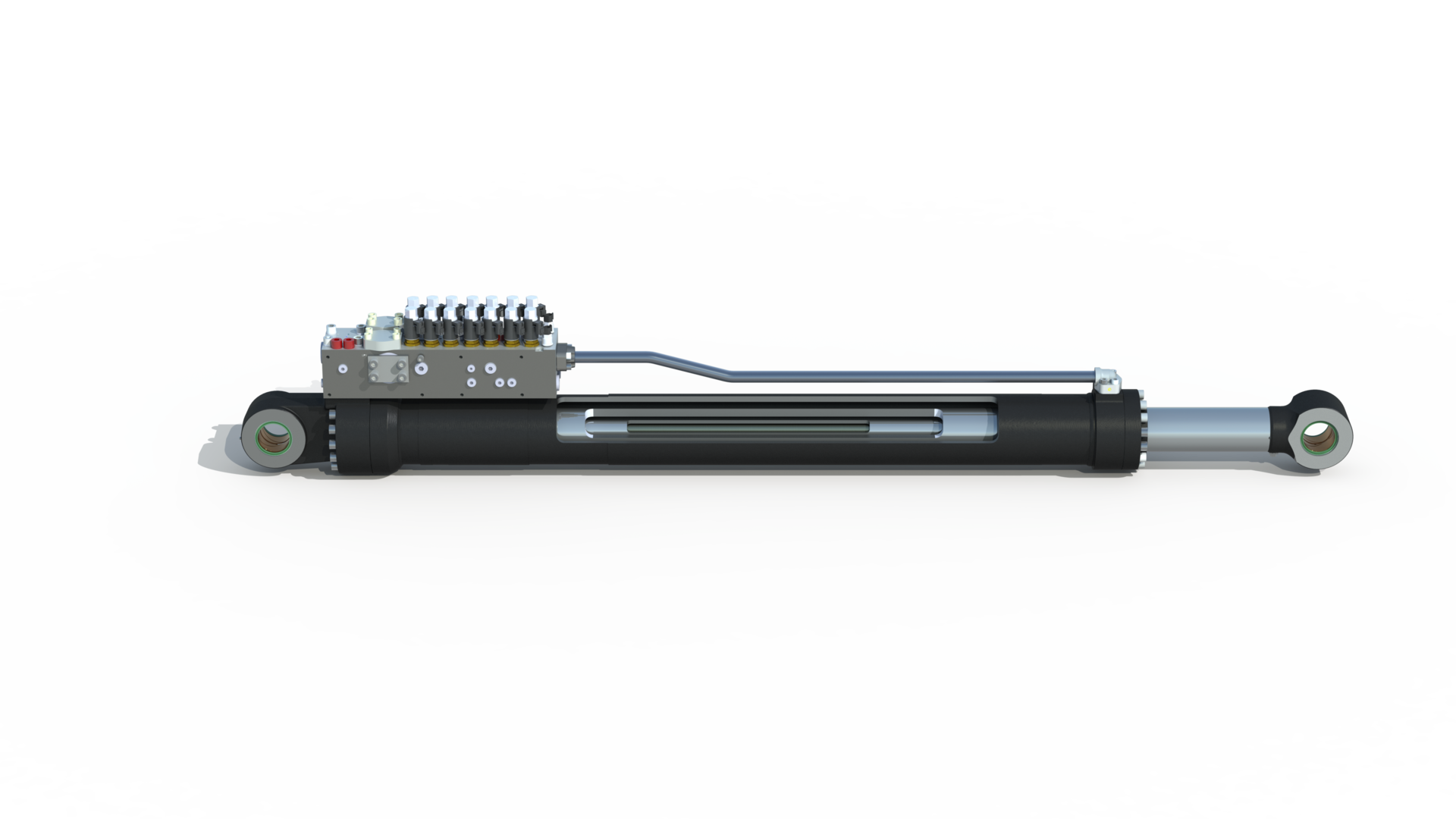

The NorrDigi hydraulic system uses digital control to improve the speed, force and efficiency of hydraulic cylinders.
Norrhydro’s NorrDigi features a digital control system to optimize the movements of hydraulic cylinders. The appropriate force and speed are applied to provide the performance needed without consuming an unnecessary amount of energy.
Key features of NorrDigi include:
  • energy stored in accumulators
  • four-chamber hydraulic cylinder design
  • data gathering capabilities to aid maintenance
  • electronic control provides improved productivity and efficiency
Digital Control Optimizes Performance
The NorrDigi system is comprised of variable flow four-chamber hydraulic cylinders and digitally controlled valves. Sixteen different movements are possible with the cylinders which use high- and low-pressure lines. The cylinders and hydraulic motors are on a common pressure and return line to the system's piston accumulators.
By utilizing digital control, not only can force and speed be more precise but also energy consumption reduced. Traditional hydraulic cylinders use throttled flows to control cylinder movements which Norrhydro explained in its press release announcing the NorrDigi's presence at IFPE 2023 consumes energy, generates heat and requires cooling. Because the NorrDigi system stores energy in the piston accumulators which directly drive the hydraulic cylinders, less energy is used which can help to improve the overall efficiency of a machine.
