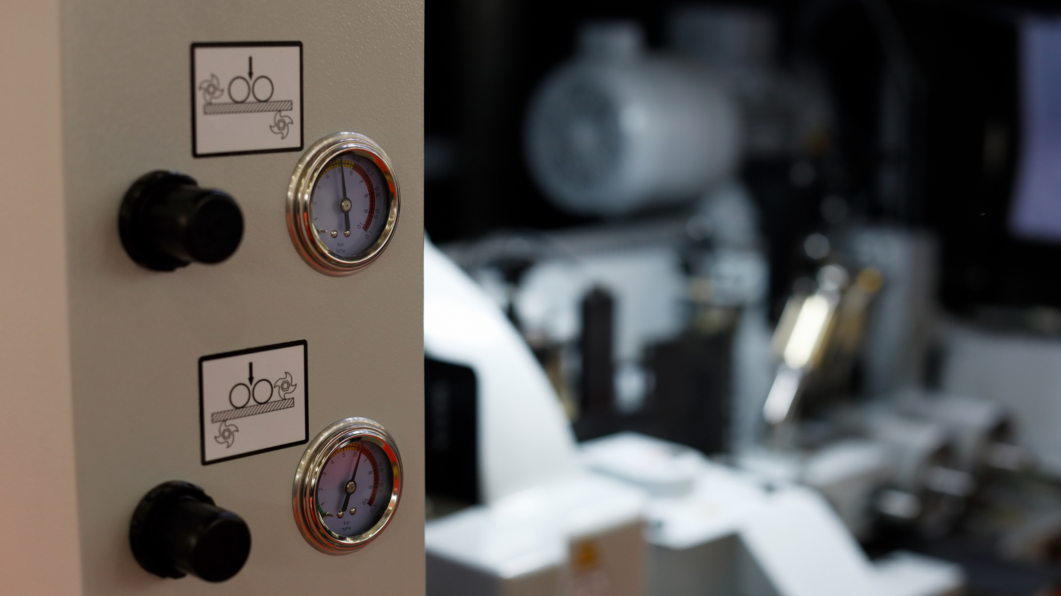

Manometers and pneumatic air pressure regulators
