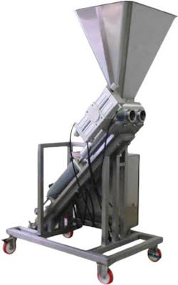

Made for easy cleaning. Actuators with domed or rounded bodies, rounded edges and a smooth finish prevent moisture, food particles and microorganisms from collecting and pooling. Particles and cleaning fluids easily drain off, improving the washdown process and minimizing the chances of contaminates lingering on the actuator after cleaning.
Even motor housings should be rounded to promote runoff. A properly designed electric hygienic actuator has no sharp edges or angles (≤ 90 deg.) and no flat surfaces (even transition features should have a radius of ≤ 6 mm.) that could create edges or pockets where food can lodge and stymie the cleaning process.

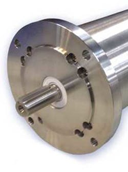

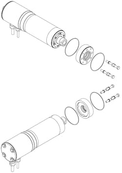

Flanges available on hygienic motors include the XXX C-Type flange (Rockwell VPH shown), which is easier to seal and clean, reduces areas for harborage and should include an FDA compliant O-ring. Before choosing a C-type flange motor, make sure the motor supplier provides an O-ring (some motor suppliers force the user to source the O-ring separately).
Another option is the XXX D-Type flange (Elwood W-Series shown), which is difficult to seal and clean. It frequently does not provide O-rings or gaskets and just suggests using RTV to seal the motor-to-actuator interface.
