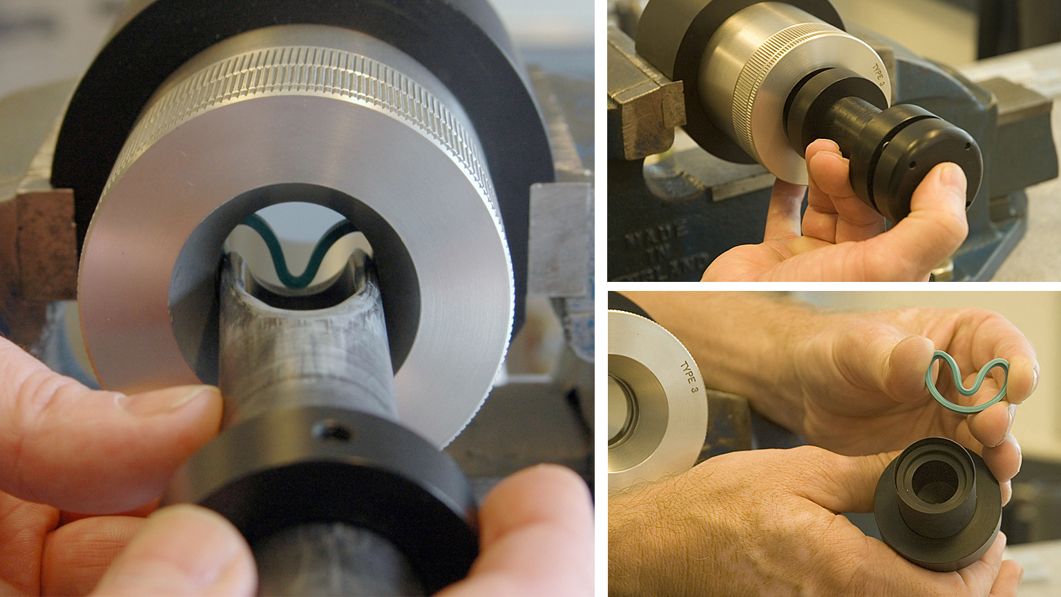

Installing Rod and Shaft Seals
Before beginning any rod or shaft seal installation, it’s important to complete the four steps outlined at the top of the article.
For assembly of an O-Ring energized seal into a split groove, place the O-Ring in the groove, press the seal jacket axially into the O-Ring, and keep the parts in place until the housing groove is closed. If the seal has a concave O-Ring contact area, it may be necessary to fold the plastic element of the seal into a kidney-bean shape during installation. Before the final assembly step of inserting the rod into the cylinder gland, elastomer-energized seals must be calibrated using a calibration mandrel or a long lead-in chamfer with a rounded edge.
For assembly into a closed groove without installation tools, place the O-Ring into the groove; compress the jacket into a kidney shape, taking care not to have any sharp bends or a bend where there is a notch. Place the seal jacket in a compressed form into the groove and push against the O-Ring to form the seal into a ring again, and then calibrate the seal using a mandrel with a long lead-in chamfer and rounded edges.
Two installation tool options are available for rod/shaft seals. For low quantities and rod diameters smaller than 30 millimeters, an inserter tube and pusher are recommended. For higher quantities, a spring-loaded, adjustable tool is recommended as it ensures repeatability in the process while reducing installation time.
Calibrating Rod/Shaft Seals Installed into Closed Grooves
Calibration ensures the rod/shaft can be inserted into the cylinder gland without damaging the seal. The seal must be concentric on the rod. Therefore, after installation in closed grooves, the folded jacket must be expanded to provide uniform contact with the O-Ring.
This can be done with a calibration mandrel or the rod. The rod can only be used on its own if the rod has a long lead-in chamfer with a rounded edge and an angle of less than 30 deg. The calibration mandrel should be made from a polymer material with good sliding characteristics (like POM or polyamide) to avoid damaging the seal. For single-acting seals, insert the calibration mandrel from the direction related to the seal profile, generally from the low-pressure side.
