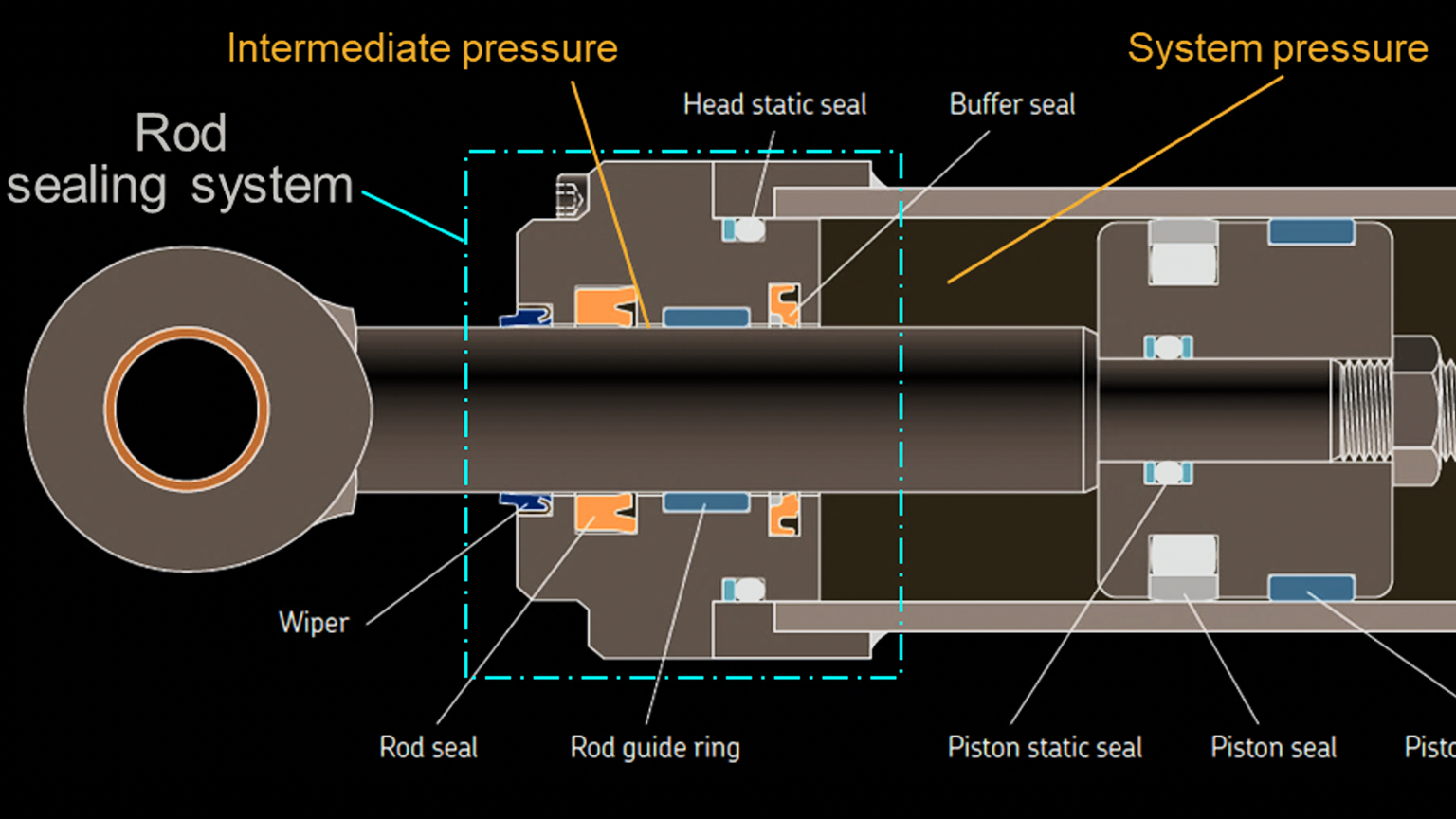

Hydraulic cylinder with a typical sealing arrangement

Designers often specify buffer seals be placed in front of primary rod seals in heavy-duty hydraulic applications to extend the life of the seals. As the name indicates, buffer seals “absorb” pressure spikes typical on heavy-duty cylinders to protect the primary rod seals.
But how do these two types of seals interactions interact, which parameters affect those interactions, and how can they be used to extend the life of cylinder rod-sealing systems?
What was learned during these investigations will give engineers insights into seal types and interactions between seals so they can specify the most appropriate seals for their applications.
Buffer Seal Basics
A buffer seal must:
  • Absorb system pressure spikes that could damage the primary rod seal.
  • Let oil move past the seal lip to lubricate the primary rod seal and wiper.
  • Vent intermediate pressure (see below) between the buffer and primary rod seal when system pressure is below the intermediate pressure, thereby preventing a pressure trap.

The key element of the buffer seal is the lubrication film thickness which passes the sealing edge. It is responsible for the performance of the entire rod sealing system. Different pressure and speed conditions during the in- and outstroke of the piston rod are typical for heavy-duty hydraulic cylinders and result in different oil film thickness. Therefore, the buffer seal needs to be designed to ensure a lubricated rod seal and absorb pressure peaks during operation.
Generally, buffer seals use one of two basic design principles:
High sealability buffer seals have good sealing abilities and can handle all of the system pressure and possible pressure peaks. Therefore, the primary rod seal will not be pressurized and can’t be damaged by pressurization. The seal’s high sealability means only a thin film of lubrication film can pass it, which could cause starve the primary rod seal of lubrication. This can lead to stick-slip, higher friction and sealing-edge temperatures, and possibly damage to the sealing material, all of which shorten the rod seal’s life.
Friction optimized buffer seals let thicker oil film pass the sealing edge to properly lubricate the primary rod seal. Depending on operating conditions, they can also let pressure build-up between the primary rod and buffer seals (intermediate pressure).
These buffer seals should keep out system pressure, because if the intermediate pressure is equal to system pressure, it cannot buffer. It is also important to use a primary rod seal and a wiper for good sealing and back-pumping ability to guarantee a leak-tight system.
An additional advantage of this type of seal is that the primary rod seal gets better lubrication, leading to smooth running equipment. If the buffer and primary rod seal work together correctly (as described above), friction in the entire rod sealing system can be similar to that of a single rod seal component. Reducing friction extends the life of the rod seal and the entire hydraulic cylinder.
Both working concepts have their place. Friction optimized buffer seals might be best in OEM components to extend a hydraulic cylinder’s service life. But high-sealability buffer seals might be more suitable in the aftermarket, where repair work and maintenance on hydraulic cylinders is more common and a leak-tight rod seal is more important.
