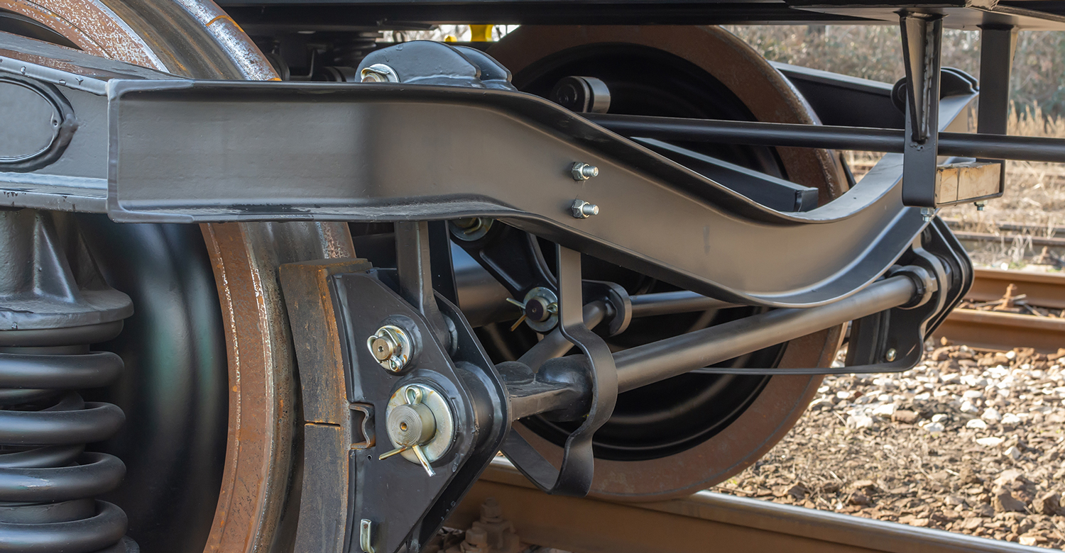

Shutterstock
Hydraulicspneumatics 6063 Promo Shutterstock 1287531346 B

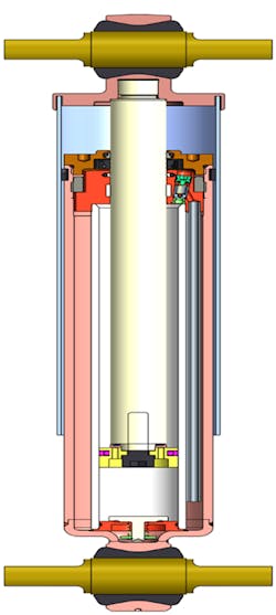

Hydraulic dampers are a primary part of the suspension system of a railway bogie, or coach. They are invisible to passengers, but their presence is evident as they sustain the weight of a train to reduce vibration and railcar wear for increased stability and comfort. Assembled inside each hydraulic damper is an arrangement of seals that allow the mechanism to absorb shock impulses.

Assembled inside each hydraulic damper is an arrangement of seals.
