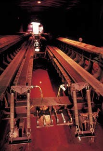

The key to slowing down the log is a pair of 40-ft brake pads at the bottom of the drop. The brake pads are completely under water, but pneumatics provides an ideal solution. Each of the two brake pads is actuated by eight air bags.
Splash Mountain culminates in a drop of more than 50 ft to a 40-ft linear braking system that decelerates riders to a safe speed. The braking system is shown here with water removed from the attraction.
Each bag is essentially a length of high-pressure hose that has been sealed at both ends, with a valve located in the middle. Pressurized air entering the bags causes them to expand and push upward on the pads. The hose is rated for 200-psi service, but operating pressure of the system is only 60 to 90 psi. When actuated, the pads contact the underside of the log, and friction gradually slows the log down to the desired speed.
The bags have no seals and produce no sliding motion that would cause component wear — which is especially important in this underwater application. The large surface area of the bags generates tremendous lifting force that is uniformly distributed over the length of the rails. Had multiple conventional cylinders been used to actuate the pads, forces would have been concentrated at the attachment point of each piston rod. This could have caused a bumpy ride as the log passed over each cylinder.
