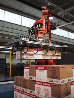

A decentralized system, Figure 1, locates the vacuum pumps closer to the points of use, and can range from a zoned system, where groups of vacuum cups that work together are isolated, to a system where each cup is completely independent of the others. Newer technology and advances in pumps (such as more compact designs) allow for a vacuum generator to be installed at each vacuum cup.

A decentralized approach, with little or no vacuum tubing, minimizes or eliminates the effects of line losses and pressure drops. Higher flows are realized at the cups, and cycle times are decreased due to increased flow and reduced volume. The increased flow adds to the reliability of the system and gives a higher safety margin. Very often, the pumps can be downsized to provide similar performance, and less operating energy will be expended.
