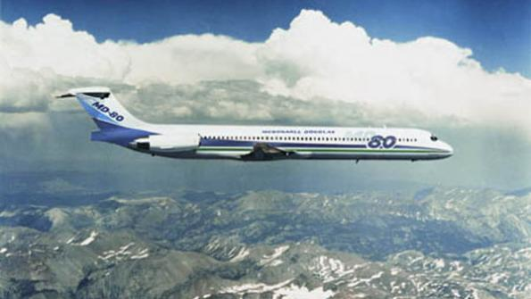

The MD-80: hydraulics simple, reliable, and easy to operate
McDonnell Douglas MD-80 retains the original DC-9's hydraulic design philosophy.
July 5, 1984
12 min read
The DC-9 aircraft was designed in the early 1960s and introduced into commercial service in 1965. The original version had a maximum takeoff weight of 76,000 lb and could carry 80 passengers. Growth versions of the DC-9 increased the aircraft capacity to 121,000 lb maximum takeoff weight in the Series 50. Today’s airplane, the MD-80, at 160,000 lb, has a takeoff weight more than double that of the first DC-9s.
The McDonnell Douglas MD-80 twin-jet aircraft has two independent hydraulic systems that operate at dual pressures — 1,500 and 3,000 psi.
