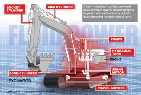

The CCEFP’s research excavator will be used to demonstrate the significant improvement in hydraulic system efficiency of heavy mobile machines that could be achieved by integrating advanced system and component designs. Click on image for larger view.
The stock load sensing hydraulic system on a five-ton Bobcat 435 excavator was replaced with a displacement controlled hydraulic system. The new hydraulic system shows a 40% fuel savings, on average, in side-by-side testing with a standard machine of the same model.
With the new system architecture, all functions are controlled electronically, thereby allowing the use of advanced control strategies. A machine power management control strategy has been implemented in addition to the displacement control platform to minimize the fuel consumption of the machine according to the working cycle performed. The improved efficiency offered by displacement controlled technology has led to lower working temperatures for the hydraulic fluid which should lead to longer fluid life and less maintenance.
