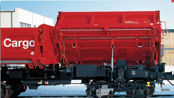

This bulk cargo rail car uses a completely self-contained hydraulic system to dump material to either side of the tracks. The system is driven by a dc motor from a battery, which is charged by a generator from wheel motion whenever the car is moving.
