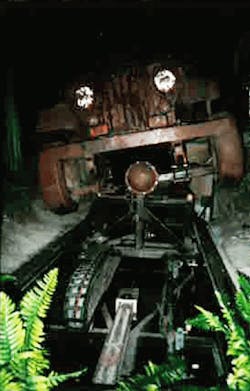

The first pursuit jeep (appropriately dubbed a "collision jeep" because one appears imminent) must hurl toward the ride vehicle, decelerate abruptly, bounce and rock in front of the awe-struck public, then quickly return to prepare for the next cycle. The collision jeep assembly is mounted to a sled, which is propelled forward by a single hydraulic cylinder controlled through a proportional valve that maintains acceleration, maximum velocity, deceleration, and return parameters.
Two four-ply, double-convoluted air springs are mounted to a steel plate which, in turn, is attached to the sled. When pressurized at 65 psi, the air springs lift the vehicle up and help propel it forward. A tank supplied by the building's air system is attached to the jeep and temporarily stores air to provide plenty of capacity on demand. Solenoid valves are switched on and off during the cycle forward, varying the air spring displacement to give the appearance of bouncing over irregular surfaces. "The action appears random and realistic," says Whittier, "but each movement is timed and planned."
