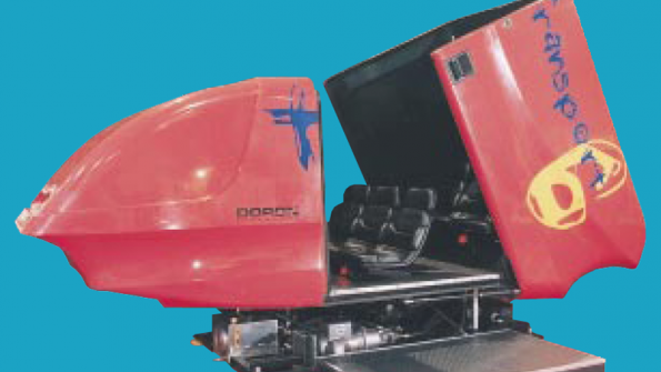

Due in large part to hydraulics, these motion simulators are compact and light enough to move from place to place but still provide realistic thrills and spills. ...
Simple, yet powerful and responsive hydraulics makes the Transport 6 cost competitive and with higher performance and throughput than its electromechanical counterparts.

Donald Wenzinger, vice president of domestic entertainment simulator sales at Doron, says the Transport 6 is light enough to be rolled on its casters from one location to another by only two people and is small enough to fit through standard double doors. David C. Byerly, senior mechanical systems engineer, adds that once the Transport 6 arrives at its destination, setup is simple because its low center of gravity means it does not have to be bolted to a foundation, and it operates from widely available single-phase, 230-V power.

View from left front of Transport 6 with motion platform raised reveals major hydraulic components. Click on image for larger view.
