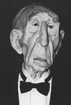

Figure 2. Jeeves the Butler demonstrates how more isn’t always better. His one move, mouth opening and closing for speech, is right on target for the stiff, stuffy character who would seem as at home at a haunted house as a high-society social gathering.
“Much of our success,” says Gene Poor, president, “is in making the right decisions for compromises. We pay close attention to the number and types of movements as they relate to the personality of a character. This means that more axes of motion isn’t always better. Jeeves the Butler (Figure 2) has one move: his mouth opens and closes. We could easily add more motions, but it isn’t necessary. He’s a very cold, impersonal butler who always looks straight ahead and talks and acts like he’s in a trance.
“We could make more sophisticated moves for other figures, such as puckering the lips when pronouncing an O or W. But this would add considerable cost to the figure and contribute little to realism. There are other ways of adding realism that are much more effective — and with little or no additional cost. It just takes some ingenuity.

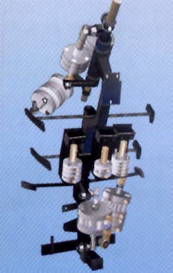

Figure 3. Drawing shows typical arrangement of pneumatic cylinders in torso. The three cylinders in the center actuate cables for eyes left, right, and blinking. Cylinders at top produce head nod, turn, and tilt; lower cylinders generate torso movements.
“Knowledge of human anatomy is essential to making lifelike figures with lifelike motions,” says Kuebler. “Cylinders become muscles. This doesn’t mean they have to be located in the same places as muscles, but they usually have to produce motion from the same places as a muscles. Sometimes this means running a cable or rod link from the cylinder to a frame member. In many cases, we locate cylinders that drive the eyes in the figure’s torso,” as shown in Figure 3. Cables run from the cylinders to the eye mechanism.
