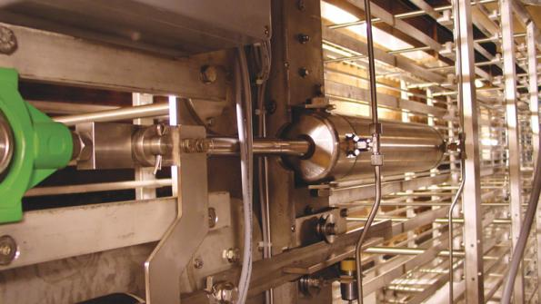

A tense situation — pneumatic cylinders provide an effective means of maintaining precise tension in long conveyors. Furthermore, smooth surfaces and stainless steel construction minimize problems otherwise associated with frequent washdowns. Click on image for larger view.
Continuous sausage production machines from Townsend Engineering use Roundline stainless steel cylinders from Norgren. With their high reliability, long life, and hygienic design, these actuators are a logical choice because they also are easy to clean and tolerate wash-down with strong detergents.

Pneumatic cylinders applied to food processing machines are likely to come into close proximity with the product. For this reason, strict requirements exist to address corrosion resistance, non-toxicity, and non-absorbency of the materials of construction. Norgren's KM/55001/M series double-acting Roundline cylinders, constructed of stainless steel, have features that closely match the application's needs.
These cylinders are suitable for areas where food is processed according to HACCP / EN 1672-2. HACCP, Hazard Analysis Critical Control Point, assesses risk of contamination by identifying hazards that may affect the quality or safety of food products and controlling them at all stages of processing to minimize risks of product contamination.
The clean line shape of Roundline cylinders minimizes surface areas where contaminant could accumulate and makes the cylinders easy to clean. Corrosion-resistant materials help maintain a smooth surface and stand up to frequent wash downs. Each sausage processing system uses 64 of these cylinders: 40 with a 100-mm bore, 12 with a 40-mm bore, and 12 with a 32-mm bore.
