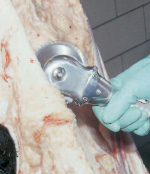

Air-powered, oscillating blades on JCIIIA skinning knife separate hide from carcass in meat-processing plants. Click on image for larger view.

One Jarvis product is the JCIIIA pneumatically powered dehider or skinning knife. In order to separate the hide from the carcass, it is necessary to cut the membrane between the hide and the fat layer over the meat. This cutting typically is performed while the carcass is suspended on a conveyor moving at the rate of 300 to 400 carcasses per hour. As many as 18 dehiding workers are assigned to this conveyor line; each is responsible for separating a small area of the hide.
Because the hide is a valuable byproduct — for leather production — one of the goals of this process is to separate the hide from the carcass without damaging the hide with scores and cuts. Of course, another goal is to avoid trimming valuable meat from the carcass along with the hide.

Jarvis discovered that oscillating blades are less prone to cut into hides, making the tool more forgiving to inexperienced operators. To accomplish this, the air motor drives an eccentric shaft via a spiral-bevel gear set. The shaft in turn rotates two drive levers that cause the blade set to oscillate, and a counterbalance minimizes vibration. The result is a shearing action between teeth on the blades. The blades' cutting speed is 6500 to 7000 oscillations per minute.
