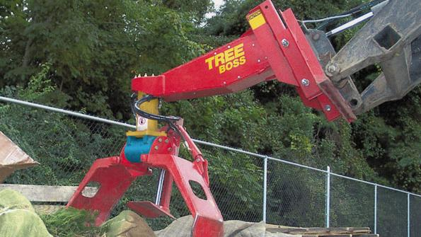

Loader Attachment Makes Tree Loading, Unloading a Breeze
A rotary actuator gives the Tree Boss’ attachment 270° of roll motion, and a second provides 100° of yaw motion. The grabber arm (actuated by a hydraulic cylinder) and foot assembly bolts directly to drilled and tapped holes in the flange and end of the actuator’s output shaft.
The Tree Boss, an attachment for skid-steer loaders, allows one person to load and unload balled trees. These are the larger trees dug up from nurseries that have their root balls wrapped in burlap to keep them intact and ready for transplant. A single operator can use the Tree Boss, manufactured by Tree Equipment Design Inc., New Ringgold, Pa., to do the job of an entire crew of four workers.
Hydraulic muscle

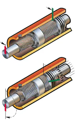

The Tree Boss utilizes three hydraulic cylinders and two helical hydraulic rotary actuators. Two cylinders operate arms that open and close to grab the root ball, and the third cylinder operates a foot that adjusts to the diameter of the root ball, providing a third contact point when grabbing the root ball. The rotary actuators work together for lifting, rotating, and positioning the tree as it’s picked up and loaded. The actuators are mounted together with their shafts perpendicular. An actuator with 25,000 lb‑in. torque capacity and 270° of rotation is mounted vertically, and one with 42,000 lb‑in. capacity and 100° of rotation is mounted horizontally.
A sliding spline rotary actuator converts linear motion of a piston to rotational output. Helical teeth machined into the piston’s outside diameter OD slide inside teeth on the inside diameter (ID) of stationary ring gear. Helical spline teeth machined onto the OD of the output shaft engage matching teeth on the piston’s ID.
Using two rotary actuators provides maximum articulation capabilities within the most compact configuration possible, while also generating high torque and eliminating the need for mechanical linkages. This permits a more aesthetic design, reduces weight, and holds down assembly costs. Furthermore, because trees generally must be transplanted within a narrow time window, frenzied work shifts often lead to equipment failures.
Rotary actuators hold several advantages over other rotational devices and actuator designs:
  • High torque output is achieved in compact configurations.
  • The shafts incorporate integral, large-diameter, drilled and tapped mounting flanges, which contribute to mounting ease and flexibility.
  • Integral, extra-large-diameter ball bearings support the shaft and enable the actuators to carry heavy radial, moment, and thrust loads without the need for additional external bearing support.
  • Eliminating all internal bypass and external leakage (and the nearly zero backlash characteristics) produces smooth, positive positioning without drift.
  • No external moving parts are exposed.
  • The helical gear design offers exceptional resistance to shock loading and abuse.
The skid-steer loader operator controls eight functions: left rotation, right rotation, tip up, tip down, grabber arms open, grabber arms close, foot in (to adjust to diameter of root ball), and foot out. An electronically controlled hydraulic valve mounted inside the boom controls all functions. The operator has access to these functions via switches integral to a handgrip that replaces the original loader’s joystick.
