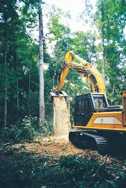

A Shinn Systems Tree Mulcher makes short work of a tree.

The Tree Mulcher, designed and built by Shinn Systems Inc., Concord, N.C., overcomes this limitation. An attachment for full-size excavators, the Tree Mulcher reduces trees, branches, etc., to a pile of mulch right at the work site — and requires only a single operator. It clears construction sites, utility right-of-ways, and recreational areas, and is particularly useful in wet areas or sites with limited access. Basically, it travels through an area and clears anything in its path, leaving a bed of mulch in its wake.

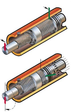

A sliding spline rotary actuator converts linear motion of a piston to rotational output. Helical teeth machined into the piston’s outside diameter OD slide inside teeth on the inside diameter (ID) of stationary ring gear. Helical spline teeth machined onto the OD of the output shaft engage matching teeth on the piston’s ID.
