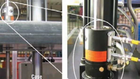

Typical installation of a safety catcher installed on a press and a closeup of the safety catcher.

A typical installation is shown in the accompanying photos. A cylinder’s piston rod is mounted to the top of the press’s platen and extends through the press crown and the safety catcher housing. The safety catcher housing is securely fixed to the machine crown frame and surrounds the piston rod, which is free to move during normal operation. Fluid pressure holds the wedge shaped clamping jaws inside the safety catcher’s housing away from the rod so it can move freely.
The safety catcher instantly engages when fluid pressure is lost or released. When this occurs, a spring causes the clamping jaws to firmly contact the rod.
