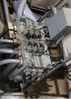

Proportional hydraulic valves offer many benefits over older-generation servo valves.

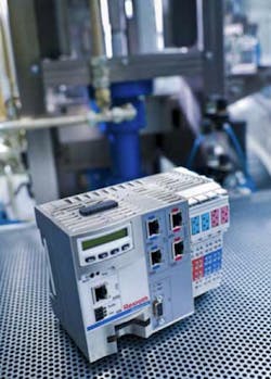

Many existing extrusion presses utilize limit switches or analog controls
to manage hydraulic cycles in the press. These legacy systems could be limiting productivity and adding to waste. Today’s state-of-the-art PLCs and closed-loop pump controllers provide much finer accuracy, whether operators are using press velocity or part temperature to manage extrusion throughput. An improved control system architecture provides greatly enhanced precision and automation of the hydraulics circuit, achieving much higher levels of position, velocity and endpoint control. These controls also allow adjustments during the extrusion cycle to keep production moving. Increased extrusion precision also leads to greater control over but length, helping reduce aluminum waste and increase the number of shapes produced per hour.

Today’s PLCs and closed-loop pump controllers provide high accuracy and allow adjustments during the extrusion cycle to keep production moving.
Hydraulic systems also can be simplified (and thus easier to operate and maintain) by replacing inline valve architectures with a single hydraulic manifold. This rationalizes the hydraulic design, reduces the leak points and hydraulic maintenance requirements and also can reduce the number of spare parts that must be stocked to keep the press operating.
Factor Two: hydraulics efficiency and effectiveness
Assess the efficiency and reliability of your hydraulics and controls systems components. You may be using less efficient, more problematic components that are actually reducing productivity. For example, many older-generation presses have servo valves to control the hydraulic pumps and the speed of the press. The servo valves are typically expensive, and require hydraulic fluid that has a dedicated filtration system with finer particulate removal than that of the existing filtration system; if the filter degrades through use, or the filtration systems are not continually maintained, the servo valves clog easily and can disrupt extrusion.
In contrast, the current generation of proportional hydraulic valves can provide the same (and sometimes better) functionality in the hydraulic circuit, yet are much more tolerant of variations in hydraulic fluid quality. This does not mean that you can ignore filtration; filtration is one of the most important elements in helping a system to survive for years. In this example, if the pump control valves are not as rugged as they could be, or require persistent maintenance leading to press downtime, a retrofit incorporating proportional valves may reduce operational costs.

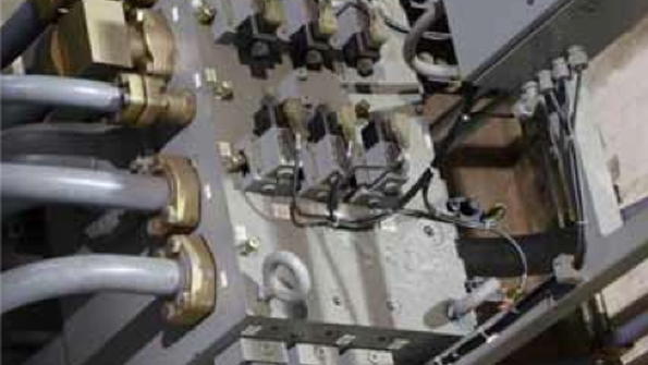

Hydraulic systems can be simplified and thus easier to operate and maintain by replacing inline valve systems with a single hydraulic manifold.

Many of these issues arise from outdated or poorly designed and/or maintained hydraulics systems—and can be easily resolved through a retrofit. For example: presses that utilize older inline valves have far more seals and points where leaks can occur than systems retrofitted with hydraulic manifolds.
In addition, limited control system design, or older controllers, may be introducing high levels of hydraulic “shock” through the press motion cycle, overstressing valves and seals. Newer electrohydraulic controls offer much finer control of the hydraulic axis, minimizing stress on the system. To reduce noise, simple enclosures of pumps and motors, or reorienting motor-pump assemblies to redirect noise, can resolve excess noise issues with minimal cost as part of an intelligently designed and cost effective retrofit.
