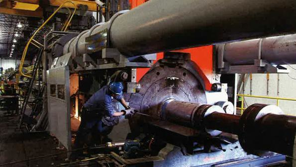

Universal Alloy Corp. (UAC), a business unit of Alu Menziken Aerospace Group, Reinach, Switzerland, and manufacturer aluminum alloys, recently purchased and upgraded the world's largest indirect extrusion press to expand its aerospace market offerings. Built in Germany in the 1940s, the 122-foot extrusion press originally made aircraft components in World War 2. The press, which now extrudes 16,200 tons, was disassembled, shipped, and reassembled at UAC's Canton, Ga. facility — where it began production in early 2005 after an extensive revamp effort.

Paul Scaglione, UAC vice president of engineering, explained that the hydraulics conversion was important to meet requirements for the next 20 years. "There were unique challenges in the conversion," said Scaglione. "We had to build the 'Swiss Army Knife' that could run direct extrusions, indirect extrusions, and seamless hollows. We also had to be concerned with the large amount of hydraulic operation above and around the heated tooling at the front platen."

Four main pumps on the press operate the 13.4-ft stroke extrusion cylinders. Each pump is rated for flows to 150 gpm.
Jim Lane and Otto Weber, systems engineers for Bosch Rexroth, worked closely with UAC to design multiple hydraulic systems for the massive press. The package included a huge 17,000-gal hydraulic system — featuring a reservoir, pilot system, motor pump groups, and manifolds.
Each of two prefill tanks is a 12,000-gal air-over-oil low pressure accumulator. Prefill tanks flow up to 7600 gpm and are charged to approximately 60 psi. Four main pumps have an output of up to 600 gpm at 4500 psi, while a container strip pump can achieve 8000 psi.
The extrusion rams advance 4.7 in./sec, and return at 4.5 in./sec. The main ram has an impressive 65-in. bore and 13.4-ft stroke. Two lateral rams have 48-in bores and 13.4-ft strokes, while two return rams feature 16-in. bores and the same stroke.
The four main pumps, which operate the extrusion cylinders, are Bosch Rexroth variable displacement servo-controlled pumps. Each has a design flow of 150 gpm. The system includes both closed-loop speed and pressure control.
