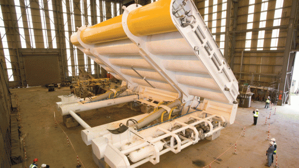

The Oyster power plant sits on the sea floor and features a large (12 × 26 m), bottom-hinged buoyant oscillator. The plant would typically be located in 12- to 20-m of water to interact with surge forces encountered in near-shore areas. The surge forces move the oscillator like an inverted pendulum, which can pivot a full 180°. The oscillator is connected to a pair of hydraulic cylinders that transmit power from the waves as hydraulic power. Each stroke of the cylinders pushes hydraulic fluid (in this case, 95-5 water-glycol) to shore through piping, where the pressurized fluid drives a turbine to generate electrical power.

The Oyster consists of a large, bottom-hinged buoyant oscillator that harnesses wave energy in near-shore areas. It produces pressurized fluid that drives an on-shore turbine to generate electrical power.

Oyster’s massive hydraulic cylinders are designed to operate underwater where servicing is difficult. They’re engineered to last 25 years and cycle about 120 million times.
