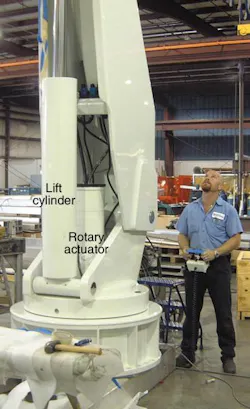

Figure 3. Deck crane undergoes testing prior to final finishing. Rotary actuator, tucked neatly behind main boom lift cylinder, provides wide arc of motion and high torque within a small, cylindrical envelope.
Rotary actuator fits the bill
Another challenge was to provide a means to pivot the davit boom once it lifts the tender from the deck. This motion requires pivoting the main arm perhaps 180° or more until it has cleared the deck and can lower the boat into the water. Thomas continues, “For the pivot drive, we could’ve used a hydraulic cylinder, but this arrangement would have limited us to only about 90°of travel. Plus, the assembly would not have been visually appealing. To gain nearly full pivot rotation, we could’ve used a hydraulic motor and a slew ring to make a conventional swing drive. But, again, the hydraulic motor would have been too noisy.”
What Nautical Structures chose instead is a helical rotary actuator with integral bearings, manufactured by Helac Corp., Enumclaw, Wash. Tom Krause, a spokesman for Helac, explains that based on output torque and rotation required, this is the most compact of any rotary actuator design available. Furthermore, he says its integral bearings produce clean, compact assemblies for a wide variety of applications, including construction and mining equipment, refuse cart dumpers — anywhere compact size, high torque, and wide angle of rotation are needed.
Referring to Figure 2, Krause explains that the actuator is composed of three basic parts: the central through shaft, the annular piston, and the housing. Helical gear teeth on the shaft mesh with matching teeth on the ID of the piston; a second set of helical teeth of opposite hand on the OD of the piston engage the housing’s integral ring gear. (See illustration for explanation of operation).
The double helix gear design works to compound shaft rotation: the rotation of the shaft is almost twice that of the piston. The result is a slender, compact, symmetrical design that generates tremendous torque, is very resilient to shock loads, and has none of the housing protrusions found in alternative designs.
Aside from the inherent compact size of the actuator, Krause adds that integral bearings and large drilled-and-tapped mounting holes make it easy to design the actuator into a structure and simplify installation. “Installation typically involves isolating the actuator from external loads by positioning it independent of the slew bearing. This prevents transmitting side loads to the actuator, so its bearings only need to support the torque load. This helps the davit operate efficiently even in rough seas.”
