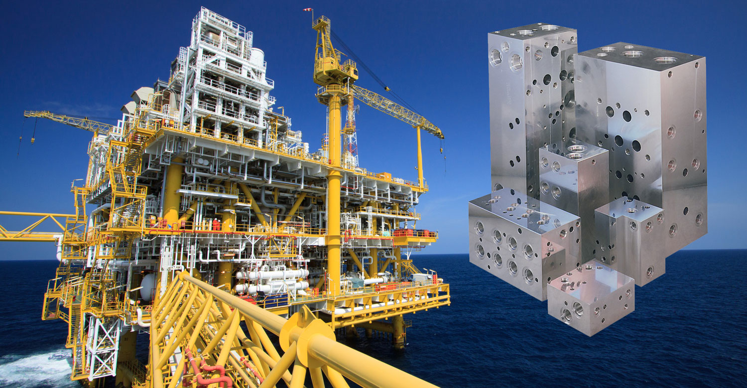

Although aluminum and ductile iron have long been the materials of choice for hydraulic manifolds, stainless steel is often the best choice.
Although aluminum and ductile iron have long been the materials of choice for hydraulic manifolds, stainless steel is often the best choice, especially for applications exposed to the corrosive effects of salt water. Known for its high strength, durability, and excellent corrosion resistance, stainless steel is the best choice for a wide range of hydraulic manifolds.
Stainless steel is manufactured by adding chromium to low-carbon steel, forming an invisible chromium oxide film on the surface. The film serves as a protective barrier that allows steel to “heal” itself simply by exposing it to oxygen. Stainless steel’s corrosion-resistant properties can be enhanced even further by adding other elements—such as nickel, nitrogen, and molybdenum—during manufacturing. The results are stain and corrosion resistance to both mechanical and chemical damage.
Project managers often overlook the numerous advantages of stainless steel because of its initial higher cost as compared to other materials. However, if you are looking for a material that can be used in a wide variety of applications and that will increase the life of your manifold, stainless steel is the best value in the long run.
Its strength, durability, and excellent corrosion resistance make stainless steel well-suited to such applications as defense, aerospace, subsea, marine, off-shore, work boats, food processing, oil and gas, and corrosive mining. These applications generally bring refer to the interaction of stainless steel with the ambient environment. However, some applications also benefit from the advantages of stainless steel interacting with the internal circuits. This is especially relevant with hydraulic systems that use water-based and other low-viscosity fluids.
Stainless steel manifolds and all valves prevent corrosive breakdown of the internal properties of the manifold and critical valve functions. For instance, water-hydraulic presses have experienced component failures after just one month of service. Using stainless-steel for these components exponentially increases the service life.
Stainless steel also carries a significant strength-to-weight advantage over other materials. Duplex grades of stainless steel possess higher strength, which translates to reduced thickness in the material. Depending on the application, this can result in lighter, more compact manifolds overall.
