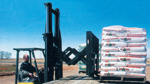

One particular model combines both of these features and more—all made possible by the innovative use of hydraulics. The lift truck features a 2-wheel hydrostatic drive (3-wheel optional) that not only provides propulsion, but speed control and braking as well. Steering is accomplished through a rear-mounted wheel that is positioned by a rotary actuator. As with most forklift trucks, the mast assembly is raised and lowered using hydraulics. But, in addition, this model incorporates a reach mechanism that is, essentially, a horizontally mounted double scissors jack. A pair of hydraulic cylinders actuates this mechanism to permit the fork assembly to reach loads positioned up to four feet in front of the lift truck.

An all-terrain truck-mounted forklift boasts many hydraulically powered features that give a big boost to productivity. One such feature is its reach mechanism, which can engage a load placed on the far side of a truck bed.

Far-Reaching Versatility
One of the most useful features of the lift truck is its reach mechanism. Essentially, this is a horizontally mounted scissors jack powered by a pair of hydraulic cylinders that extends the forks forward up to 48 in. This allows the vehicle to unload a truck entirely from one side of its cargo bed. Not only does this increase productivity, but it also improves safety because operators don’t have to venture out onto the traffic side of a truck to unload it. Also, if an operator needs to reach a loaded pallet that lies behind another one, he or she can extend the forks forward and above the obstacle to gain access to the load without having to move the pallet that’s in the way.
