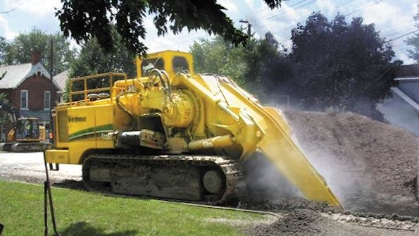

Hydrostatically controlled cutting drums with carbide teeth on Terrain Leveler mine swath 12 ft wide and up to 30 in. deep. Vermeer's 2000.2 Trencher Electronic Control System monitors operating conditions, measures ...
Designers at Vermeer Mfg. Co., Pella, Iowa, developed the Terrain Leveler as an attachment for their established T1255 Commander rock trencher. The machine combines toughness with technology. The Terrain Leveler is aimed at the burgeoning crushed stone market — specifically gypsum, coal, cement, and limestone materials. Large hydrostatically controlled cutting drums replace the trencher's digging chain. The drums can cut a swath 12-ft wide and up to 30 in. deep. Their hydrostatic drive systems produce deep tooth penetration and better efficiency than drilling or blasting. The result — larger chunks of material with fewer material fines. The equipment also can perform on overburden-removal soil-mixing/remediation, rockexcavation, concrete-removal, and road-construction applications.
Vermeer's 2000.2 Trencher Electronic Control System monitors operating conditions, measures full-range ground and head-shaft speed; display informs the operator of machine performance in real time.
The T1255 trencher — with a 6-cylinder, 600-hp Caterpillar C-16 diesel engine — serves as the Terrain Leveler's tractor. Its tracked ground drive is controlled by a dual-path hydrostatic system with a pump/motor/planetaryfinal-drive for each track. This configuration makes full independent counterrotation of the trencher tracks possible for greater machine maneuverability.
