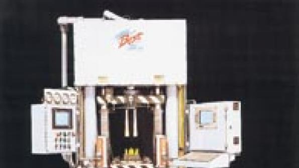

The latest hydraulic presses can produce complex parts more economically and with higher quality than even the best mechanical press. This performance superiority is demonstrated by a new generation of powder-compacting press, Figure 1, from Best Press. A main feature of this press is that it forms complex-shaped molded parts with uniform density - even with irregular or varying cross sections - from a wide range of powder materials.
Hydraulic press steps up
Uniform material (powder) loading is critical to achieve uniform density in the finished part. To this end, Best Press uses multi-stage, hollow-rod, and conventional double-acting cylinders to form a cavity in the mold. Powder is pushed into the cavity and then compressed by the cylinders into the shape of the part being manufactured. The powder has binders in it that, along with the pressure, hold the pressed part together. After the compression step, the part is baked (a process known as sintering) to impart strength and hardness to the final product. The process of forming products in this manner eliminates the expensive machining step used in traditional manufacturing.
The machine actually goes through multiple steps in the molding process. Each step is coordinated by a closed-loop control algorithm with cylinder position feedback provided by magnetostrictive linear-displacement transducers (MLDTs) and pressure feedback from pressure transducers. The steps are:
1. Go to fill position - During this step, the cylinders move to a home position for filling the cavity with powder. The lower main cylinder retracts downward and the top cylinders extend upward.
2. Material transfer phase - A feed shuttle extends to fill the powder cavity in a single operation. Next, the shuttle retracts as the upper cylinders extend downward to close the cavity. All cylinders move simultaneously into position to begin compressing the material. During this phase, velocity of the upper cylinders is precisely ramped down to avoid pushing material out of the cavity. As this step continues, the upper and lower cylinders come in contact with the material. The cylinders must all move simultaneously to displace the material equally and prevent the creation of voids in the mold cavity.
3. Compression phase - Once the cylinders extend to begin compressing the material, the control algorithm seamlessly switches from closed-loop position control to closed-loop pressure control for all axes. During the compression (or tonnage) phase, pressure is applied to each cylinder in a synchronized procedure so that all cylinders achieve peak pressures at the same time. This is the feature that allows the press to produce a part that has uniform density throughout.
4. Eject phase - After the compression phase has been completed, all axes must move simultaneously to eject the part. Care must be taken not to compress the part any further. The part is pushed up out of the die cavity by the lower cylinders, and the feed shuttle then comes forward as the upper cylinders retract out of the way to their home position, readying the press for the next cycle.
