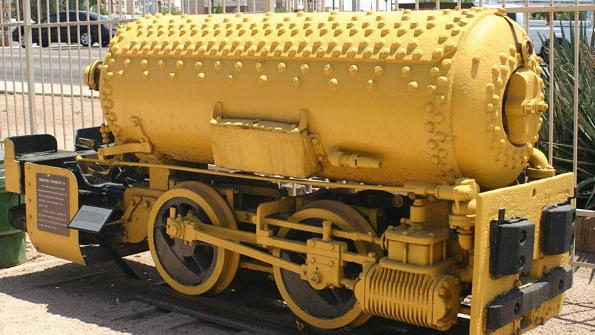

If you travel to Chandler, Ariz., you can see a sample of this mature technology that is still widely used today in one form or another. Fireless locomotive #3290, displayed at the Arizona Railway Museum, was built by the H. K. Porter & Co. in 1905 and was used by Homestake Mining Co. until it was retired in August 1985. Homestake Mining Co. was one of the largest gold-mining companies from the 1800s until it merged with Canada’s Barrick Gold Corp. in 2002.
The locomotive has a 0-4-0 wheel arrangement, weighs 10,000 lb, and its 23-in. drive wheels were designed to produce a tractive effort of 18,600 lb. Rated at 1,000 psi, its receiver fed drive air cylinders, each with a 6-in. bore and 10-in. stroke.
The locomotive was donated by Homestake Mining Co. to the Museum and has been on display at the Arizona Railway Museum since 1997.
