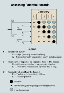

If a hazard identification and risk assessment of a machine identifies a hazard for which an engineering control method (such as an interlocked access guard) is to be installed, then the relative category for the safety control system integral to the control method should be derived. (Appendix F of AS4024.1 provides guidance on selection of categories).
The requirements and system behavior of the category are designed to provide a practical level of safety control resistance to faults with respect to the potential severity of injury, exposure to the hazard, and possibility of avoidance and can be found summarized in table 10.3 of AS4024.1.
If a hazard could cause a serious, normally irreversible injury (including death), then a preferred category of 2, 3, or 4 will be derived depending on the combination of exposure and possibility of avoidance (see chart). For these categories fault detection is called for in safety related parts of the control system. This includes the electrical, pneumatic, and hydraulic component. The intent is that if a fault is detected, further operation of the machinery can be prevented until the fault is diagnosed and safely resolved.
This chart summarizes assessment of risk and severity of results.
In addition, Categories 3 and 4 require that a single fault in the control does not lead to the loss of the safety function. Thus, if a component fails, a redundant or second device must still maintain the safety function.
