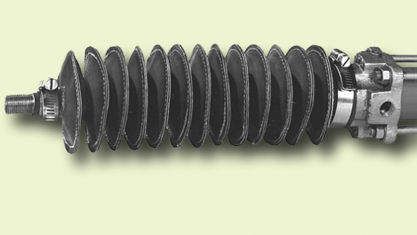

Figure 1. Boots of standard stitched construction meet demands of most applications cost effectively, especially in small to medium quantities.

Standard stitched-construction boots, Figure 1, protect internal components from damage by common contaminants and nominally severe environments. Assembled from rings of elastomer-coated fabric sewn along alternating inner and outer circumferences, these boots will exclude most dust, dirt, chips and coolants. For added sealing or abrasion protection, seams can be coated after stitching. This construction offers the widest choice of materials for all types of service requirements and allows the greatest E/R length ratios. End collars or flanges for mounting can be any size or shape, whether larger or smaller than the boot.
Stitched bellows cannot be completely sealed, so adherence to air-, light-, or dust-tight requirements cannot be guaranteed. Coating helps, but a sewn boot still tends to “breathe” through its seams. For areas where fine contaminants require more complete exclusion, it may be necessary to seal the boot so tightly that it may collapse if the travel speed is too rapid. Realize that the boot is actually a bellows, so a vacuum is generated during rod extension, and internal pressure develops during retraction if adequate venting is not provided. Methods will be described for providing the necessary makeup air while still excluding contaminants.
