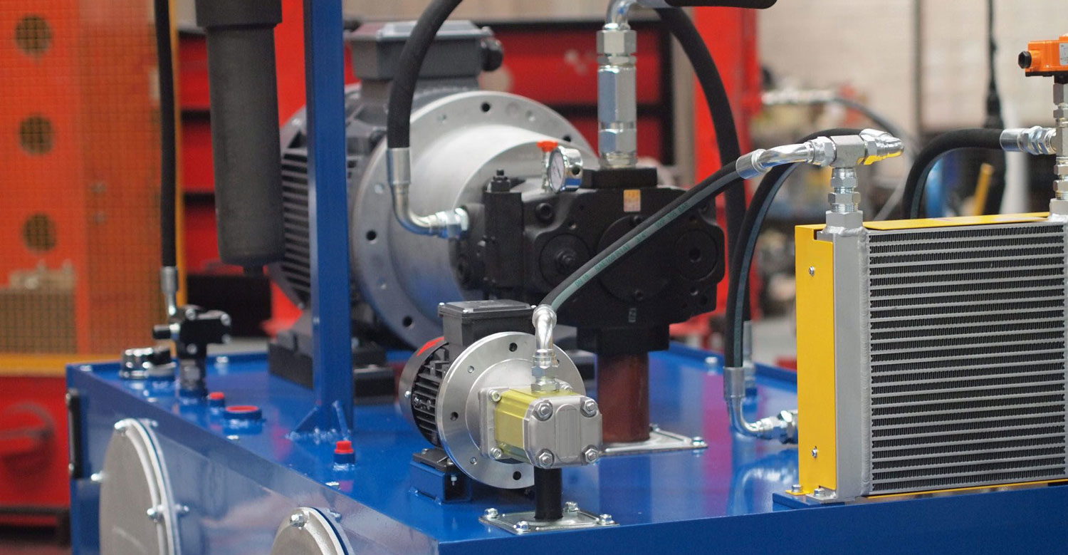

I mention this story because many hydraulic machine builders and end users share the late Jobs’ dislike for heat rejection devices—oil coolers, in our case. But it can’t be said that an oil cooler on a hydraulic machine detracts from the user experience. Instead, an oil cooler—or an oil cooler of sufficient size—is resisted due to one or more of the following:
  • initial cost,
  • required maintenance,
  • the space it requires, or
  • the weight it adds to the machine.
In fact, during a time when I was designing and building hydraulic power units for end users, I can recall dealing with customers whose desire was no oil cooler and the smallest tank possible!

Let’s consider a tank with an oil volume of 200 liters and area (excluding its base) of 1.7 m2, an ambient air temperature of 35° C, and an operating oil temperature of 85° C. In a “normally ventilated” space, the theoretical heat rejection of the tank is:
(85-35) × 1.7 × 12 ÷ 1,000 = 1 kW
For the purposes of illustration, let’s say this calculation is too conservative, so we’ll double the above number. In other words, we expect the 200-liter tank will dissipate 2 kW of heat. Working backwards from this number, if we want the hydraulic system to have an installed cooling capacity of 25% of input power (and the tank is the only installed cooling), then the maximum, continuous input power allowable is just 8 kW! Obviously, the idea of a big (or bigger) tank in lieu of an oil cooler is not realistic in most applications.
If you accept the fact that energy-wasting pressure drops are unavoidable in any hydraulic machine, then so, too, is an appropriately sized oil cooler in most applications. Because when it comes to hydraulic machine reliability, uncontrolled energy contamination can be just as bad, or worse, than uncontrolled particle contamination.
