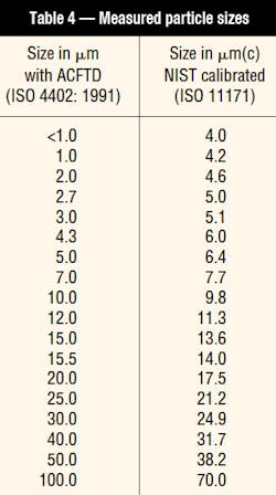

NIST certification and new calibration
The US National Institute of Standards and Technology (NIST) undertook a project to certify the particle-size distribution of ISO MTD suspensions in oil. From this study, the Institute determined that for particle sizes below 10 µm, the actual particle size is greater than previously measured using an automatic particle counter that was calibrated with ACFTD. Above 10 mm, the particles were smaller than under the old calibration system. To make a distinction, particle sizes based on the new NIST determination will be represented as X µm(c), with the (c) designation referring to certified calibration that has sizes traceable to NIST. Thus, particle size has a new definition, Table 4.
ISO Technical Committee TC 131 replaced the old APC-calibration procedure, ISO 4402, with a new procedure, ISO 11171, which incorporates ISO MTD test dust with the NIST particle-size and particle-count determinations. It also has included a number of other enhancements to ensure better accuracy, reproducibility, and repeatability. In addition, ISO has developed another procedure, ISO 11943, for calibration and verification of on-line automatic particle counters. Because APCs are used for multi-pass filter performance testing and fluid contamination measurement, these changes will affect reported results.
ISO has adopted a revised procedure for reporting fluid-cleanliness measurements from APCs that have been calibrated with the new NIST-traceable method. This procedure, ISO 4406: 1999, uses three code numbers that correspond to concentrations of particles larger than 4, 6, and 14 µm(c). The new 6 and 14 µm(c) sizes correspond closely to the older 5 and 15 µm sizes reported by the old ISO 4406 coding system measured with an APC calibrated with ACFTD. The new 4 µm(c) size, however, corresponds to about the 1 µm size if the ACFTD calibration procedure had been used. This difference results in somewhat higher values of the first digit when compared to current three-digit codes that reference particles larger than 2 µm using the old ACFTD-calibration method.
