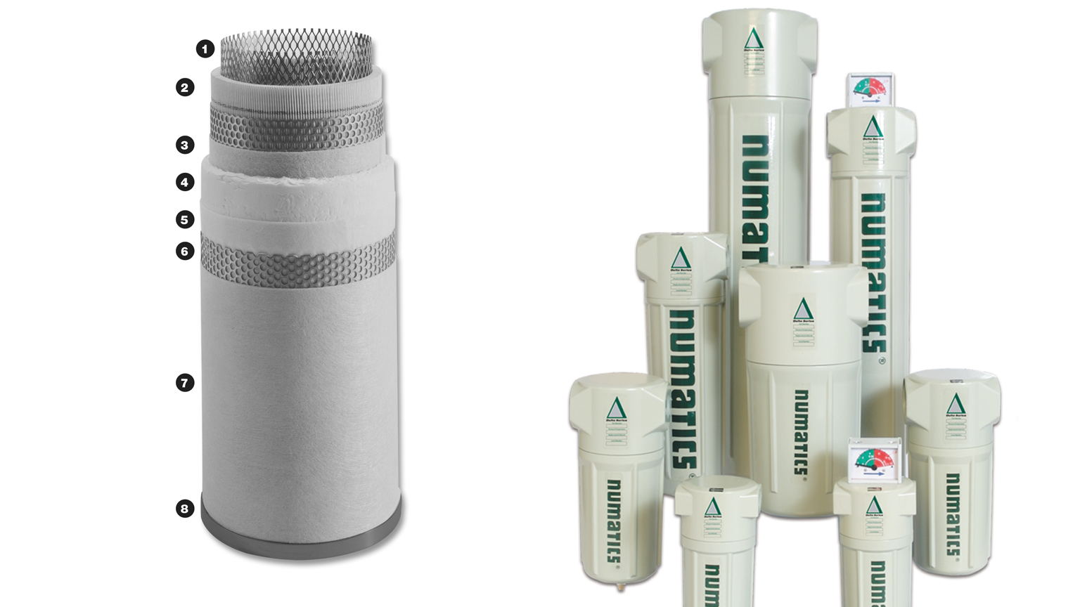

Filter Types
The most common types of industrial filters:
Water separators. Water or moisture can quickly damage pneumatic components, causing valves and cylinders to stick. Water separators rely on centrifugal forces generated by an internal spinning mechanism to remove water and waterborne contaminants. In addition, they protect other filter elements from liquid that could shorten filter life.
Particulate filters. Large particles, such as rust, debris and desiccant dust, can cause premature failures in pneumatic components. These contaminants are often generated by old carbon-steel pipes, compressor intakes, and desiccant air dryers. The most effective particulate filters use pleated designs, maximizing the surface area that traps particles. Particulate filters often achieve three-micron particle removal in dry systems.
Coalescing filters. At the next stage of air filtration these filters remove water, oil, rust and other contaminants from air supplies. The design of coalescing filters may vary, depending on the manufacturer. For example, some higher-quality coalescing filters consist of a porous network of borosilicate glass fibers. Air flows from the inside to the outside of the filter via progressively larger openings in the media. As contaminants move through the element, solid particles are trapped and liquids formed into large droplets that drain away. Then, as air exits the filter, surface tension holds the liquids, letting them drain to the bottom. Coalescing filters are available in different grades.
Typically, coarse coalescers are used for mainline plant filtration while fine coalescers are used for applications such as pneumatic tools, robotics and paint spraying. Ultra-fine coalescers are usually point-of-use filters for processes such as semiconductor packaging and instrumentation.
Adsorbing filters. These filters are often the final step in removing oil and hydrocarbon vapor from compressed air. Adsorbing filters are usually used immediately downstream from a coalescing element. Adsorption is best done at lower temperatures, so it’s a good move to install them as close to the point of use as possible. Adsorbing filters are often used to treat breathing air, well as food and drug applications in which the product contacts the exhaust air.

Common filter types are sometimes referred to generically, but there are substantial quality and performance differences between filters from different manufacturers, even if they have the same nominal filtration specification. Filter design and manufacturing methods are often at the root of these differences.
Coalescing filters show the importance of design and manufacturing. Commodity coalescing elements often use a mechanically wound filter media. Higher-quality coalescing filters, however, employ a vacuum-formed filter media composed of glass fibers and an epoxy binder.
This difference makes a significant impact. The vacuum-formed design traps contaminants through the filter’s entire cross-section. This gives it a higher capacity and lower pressure drop than a comparable wrapped filter that mainly traps contaminants on the surface, quickly clogging as a result. It’s best to choose filters with an initial pressure drop of just 1.5 psi in a dry condition at rated flow, which is far lower than a typically wrapped filter. Lower pressure drops decrease energy consumption.
In addition, the vacuum-formed design lets the filter be customized to meet specific filtration levels. Some filter manufacturers can adjust the vacuum-forming process to form coalescing elements ranging from 0.01 micron to 1.0 micron.
Construction variations affects other filter types, too. Some higher-performance adsorbing filters, for example, consist of fine activated charcoal impregnated on polyester. These carbon particles have a strong affinity to vapor and are highly efficient due to their extensive surface.
