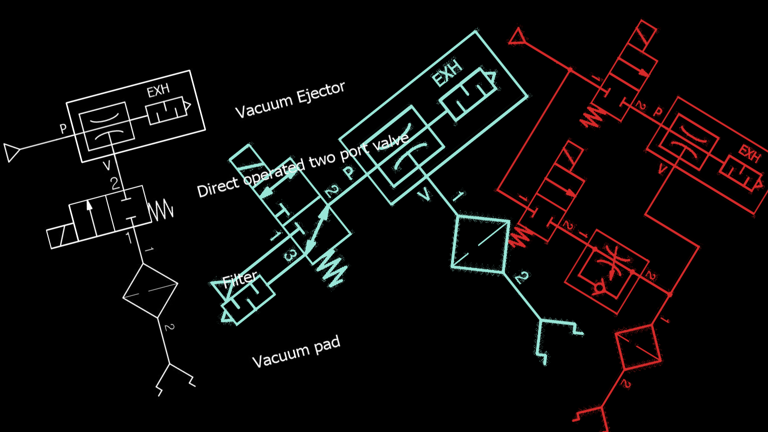

For example, take a look at the schematic below. It shows a basic vacuum pick-and-place circuit. A venturi ejector generates a vacuum and a two-port valve applies or switches off vacuum to the pad. Do you see any issues? Is there a reason the solenoid valve would not operate?
There is a detail in the valve symbol which engineers can easily overlook (and on occasion do), especially if the engineers are unfamiliar with pneumatic symbols. This type has an internal air pilot, and for the valve to open, compressed air pressure is needed at the inlet port (port 1). An internal orifice directs some supply air to an internal piston or another mechanism that moves the valve spool.
Instruction manuals for these types of valves specify a minimum operating pressure for the valve to switch position. This is the pressure which acts on the internal piston/other mechanism, moving the spool to let air flow to the outlet port (open the valve).
If vacuum pressure is acting on port 1, the minimum operating pressure cannot be reached, and the valve remains closed. Not all manufacturers add dashed lines in their symbols to identify internal air supplies to a pilot to make it obvious.
A better choice of valve when using this setup for vacuum applications is a direct-operated type such as the direct-operated solenoid type shown in the example below. These valves do not require a minimum operating supply pressure. The solenoid pulls an internal armature to open the valve or move the spool to allow flow. This type of valve will operate under vacuum pressure.

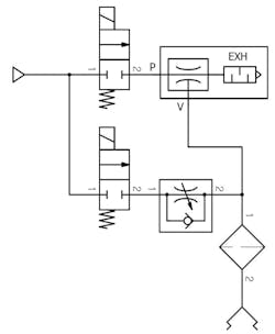

It can still be more efficient. If fast cycle times are required, consider using positive air to release the workpiece from the pad quicker and more cleanly (on occasion, workpieces stick to a vacuum pad). By using two 2 port valves, one can supply the ejector, and when it is time to release, cut supply to the ejector and use the other to supply pressure to the pad, releasing the workpiece cleanly. When doing it this way, it is a good idea to use a speed controller in the release air line, as too much flow could blow a light workpiece away from where it is supposed to land.
