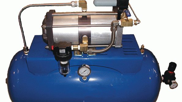

This 80-gal air receiver has an air pressure top-mounted intensifier, which provides air at a higher pressure than would normally be produced by a conventional compressor.
