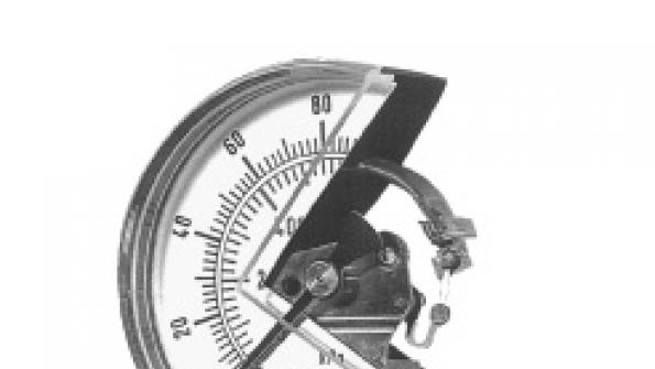

Fig. 1. Cutaway view of C-shaped Bourdon-tube pressure gage. Pressure-induced strain in the Bourdon tube causes it to deform. Transmitting this deformation to a pointer through a movement linkage provides a visual indication of pressure.
Since the invention of the Bourdon-tube gauge more than a century ago, pressure gauge manufacturers have been developing different types of gauges to meet specific needs without ever changing the basic principle of the Bourdon tube's operation. Bourdon-tube gauges, Figure 1, are now commonly available to measure a wide range of gauge, absolute, sealed, and differential pressures, plus vacuum.
They are manufactured to an accuracy as high as 0.1% of span and in dial diameters from 11/2 to 16 in. A variety of accessories can extend their performance and usefulness. For example, snubbers and gauge isolators can be installed to protect the sensitive internal workings of the gauge from pressure spikes. The availability of Bourdon-tube pressure gauges to meet specific needs, coupled with their inherent ruggedness, simplicity, and low cost has resulted in their wide use in many applications.
Gauges using C-shaped Bourdon tubes as the elastic chamber - the type shown in Figure 1 - are by far the most common. Pressurized fluid enters the stem at the bottom (which is sometimes center-back-mounted instead) and passes into the Bourdon tube. The tube has a flattened cross section and is sealed at its tip. Any pressure in the tube in excess of the external pressure (usually atmospheric) causes the Bourdon tube to elastically change its shape to a more circular cross section.
This change in shape of the cross section tends to straighten the C-shape of the Bourdon tube. With the bottom stem end fixed, the straightening causes the tip at the opposite end to move a short distance - 1/16 to 1/2 in., depending on the size of the tube. A mechanical movement then transmits this tip motion to a gear train that rotates an indicating pointer over a graduated scale to display the applied pressure. Often, a movement is incorporated to provide mechanical advantage to multiply the relatively short movement of the tube tip.
