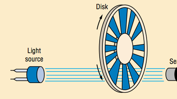

Fig. 1. Components of an incremental optical encoder.
Encoders - Encoders are non-contact digital devices that, in their simplest configuration, provide a defined number of pulses per revolution or per unit of linear displacement. Encoders produce digital pulses typically in 5-V DC, by consecutively completing and breaking an electronic circuit. This on/off sequence allows changes in position to be detected and measured. There are two typical transduction methods used in encoders; optical and magnetic.
An optical encoder, Figure 1, consists of a light source, a light sensor, and a grid. The grid can be constructed of glass, metal, or plastic. It consists of alternate transparent and opaque areas that either allow or prohibit the passage of light from source to the sensor. This blocking and unblocking causes the associated electronics to generate a string of pulses. Magnetic encoders replace the grid with magnets, and the light source and sensor are replaced with devices that sense the changes in magnetic fields.
There are two types of encoders, incremental optical encoders (such as the arrangement shown in Figure 1) and absolute encoders.
