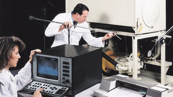

Fig. 1. Power units are notorious for generating most of the noise in a hydraulic system. An important step toward quieting them down involves first determining the nature and sources of noise.

A hydraulic system's greatest contributor to noise is the power unit, Figure 1. Noise not only emanates directly from the electric motor and pump, but also is caused by pressure fluctuations in the hydraulic fluid and by components — either resulting from these pressure fluctuations or from physical vibration. Transmitting vibration of the pump-motor assembly to the reservoir can transform this physical vibration into sound - in the same way a loudspeaker transforms electromagnetic vibrations into sound.
Electric motor noise comes from bearings, the rotor and stator assembly (the characteristic hum), and, especially, the fan. A standard electric motor contains a fan with blades designed to provide cooling whether the motor shaft rotates clockwise or counter-clockwise. A fan designed for rotation in only one direction will generate less noise, so the expense of this option may be warranted if the application demands quiet operation.
Pump noise stems from rolling and sliding of bearings and pumping elements (vanes, pistons, rotors, gears, etc.), plus pressure fluctuations that result from the cyclical nature of the pumping process. Metal housings, whether part of the hydraulic pump or an electric motor, do little to prevent noise from being transmitted to the surrounding environment. Moreover, because the pump generally is coupled to an electric motor (and the coupling itself is a source of noise), noise control often involves treating the pump-motor combination as a unit. This design technique has produced power units where the pump-motor combination is submersed in oil or where the entire power unit is submerged in the reservoir. This technique uses liquid to dampen sound waves by acting as a buffer between the pump-motor housing and the surrounding atmosphere.

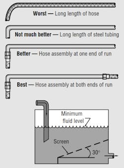

Although reducing fluid-borne noise can be complicated, many manufacturers suggest rules of thumb to help reduce noise. For example, terminating a long run of metal tubing with a section of hose at each end helps isolate noise sources, Figure 2. One might be tempted to simplify the design by instead specifying a single section of hose. Hose, however, is very sensitive to pressure pulsations, so in long sections it can be a greater source of noise than metal tubing or pipe.
Securing tubing to framework with resilient clamps eliminates rattling and banging noise. However, care should be taken not to confine tubing too tightly, because lines may need to undergo thermal expansion. On the other hand, allowing a tube to fit too loosely could cause wear as the tube constantly rubs against a metal clamp surface. Likewise, resilient grommets should be used when a hose or tube passes through a hole in framework, covers, etc.

Figure 2. Many simple techniques can be employed to quiet a noisy hydraulic systems. Among these are incorporating hose into long tubing assemblies, top, and using a 60-mesh screen positioned 30° from horizontal.

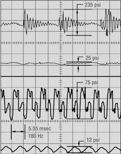

Figure 3. Surge suppressor, shown in Figure 4 installed on a pump outlet, takes up much less space than an accumulator. Oscilliscope readings, shown above, illustrate how suppressor dramatically reduces pressure pulsations, and, therefore, noise.
Another method of quieting the power unit is to reduce pressure pulsations. Accumulators often are specified for this purpose, but their effectiveness is limited because they dampen pressure pulsations within a range of frequencies for a given size and precharge pressure. Moreover, accumulator calculations are complicated, and several accumulators may be required to dampen the full range of pulsation frequencies experienced by a system.
An alternative is to mount an in-line surge suppressor to dampen pulsations over a wide range of frequencies, Figure 3. One such suppressor consists of a housing containing an annular area that holds a pressurized charge of nitrogen, a cylindrical membrane, and a perforated tube, Figure 4. Under normal operation, fluid simply passes through the suppressor by entering one end of the tube and exiting the other. However, if pressure increases - from pump pulsation, for example - the fluid passes radially outward through the tube perforations, overcomes the nitrogen charge pressure, and expands the diaphragm outward. Allowing pressure fluctuations to act against the pressurized nitrogen cushions the vibration, so output pressure is much smoother - and, therefore, pump operation is quieter. Moreover, sizing is simple, because the suppressor is selected according to the size of the pump discharge line.
