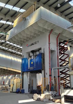

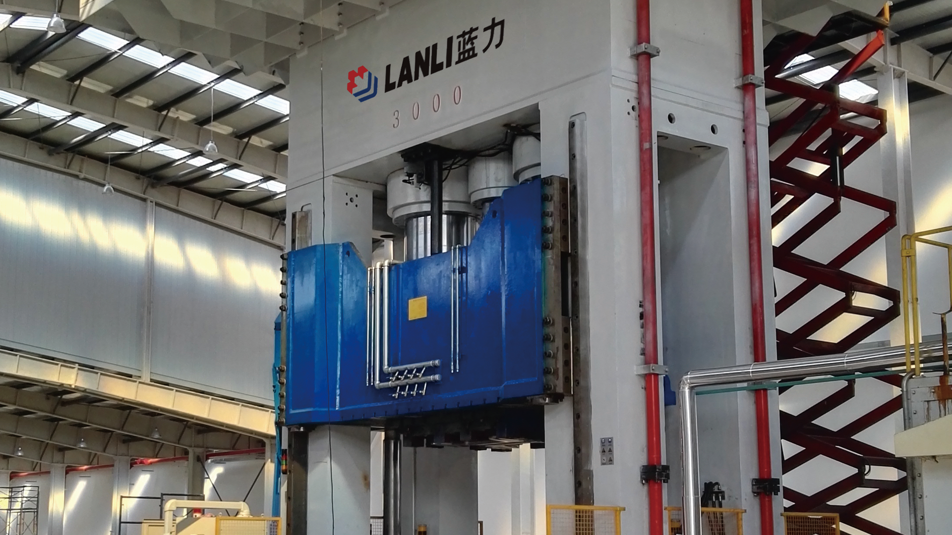

An automotive parts manufacturer uses a four-corner press produce tight-tolerance auto body panels (Fig. 5). At 30 ft (~10 m) in height, the press is very tall. The servo valves controlling the four hydraulic rams were mounted at floor level, while the cylinders they were controlling were up higher on the press.
An advanced motion controller was able to account for the non-linearities and lag in system response resulting from the fact that the system had extra oil between the valve and cylinder, as well as flexible hose which expanded under pressure. Once the system was characterized, the controller was programmed to correctly anticipate system response, and smoothly position the die cushion and maintain a constant force on the workpiece. The resulting press produces parts to a high degree of accuracy and moves smoothly between pressing and retracting with no oscillation. Prior to setup, the press would oscillate, shaking the building where it was installed!
