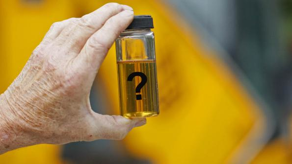

A hydraulic oil's oxidative condition is determined by an absolute measure of its total acid concentration. When oxygen combines with hydrocarbon molecules a chain reaction occurs, which results in the formation of organic acids. These substances darken the oil, increase viscosity, reduce foaming resistance and air release, and form varnish and sludge. In other words, the oil becomes unserviceable.
There are generally two conditions which necessitate an oil change. One of these is oxidative degradation. And the only way to know if the oil's life has expired based on this condition is to do regular oil analysis.
The total acid number (AN) test result is expressed by the volume of the alkaline, potassium hydroxide (KOH) in milligrams (mg), required to neutralize the acidic components contained in one gram (gm) of used oil.
Due to their additive composition, new zinc-based, mineral hydraulic oils can have a rather high initial AN of 1 to 1.5 mg KOH/gm. This number initially decreases as additives deplete. But as the oil starts to age and oxidize, the formation of acidic by-products reverses this trend and causes AN to rise.
For mineral hydraulic oils, AN of 2.0 mg KOH/gm is the typical trigger value for an oil change. But for synthetic esters and some triglycerides (vegetable based oils) AN can be as high as 5.0 mg KOH/gm before an oil change is required.
