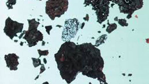

Hydraulic fluid straight from the drum, has a typical cleanliness level of ISO 4406 23/21/18. A 25 GPM pump operating continuously in hydraulic oil at this cleanliness level will circulate 3,500 pounds of dirt, on an accumulative basis, to the hydraulic system's components each year!
