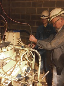

2. How to Read and Use a Schematic as a Troubleshooting Tool
Most industrial systems are much too large and complex to troubleshoot without a schematic. Often, portions of a machine are in different rooms or even different buildings. The schematic shows how the entire system is plumbed, allowing the troubleshooter to trace the flow and use his knowledge of the function of the components to eliminate those that could not be causing the problem and identify those that could be.
Trying to trace the flow without a schematic can be laborious at best, but impossible in some cases. It is usually possible to troubleshoot something simple such as a log splitter without a schematic, but anything much more complex requires a schematic.
If a system has manifolds, troubleshooting is impossible without a schematic. Since we aren’t Superman with X-ray eyes, we have no way of knowing exactly how components are connected inside a manifold. There may be internal plugs or orifices and there may be cross connections we are unaware of. Without a schematic, the best anyone can do with a manifold is make an educated guess.
The best five minutes ever spent troubleshooting a system will be spent tracing the flow on the schematic. In fact, we go so far as to say that, if you are not using a schematic as a troubleshooting tool, you aren’t really troubleshooting. You are really parts changing.

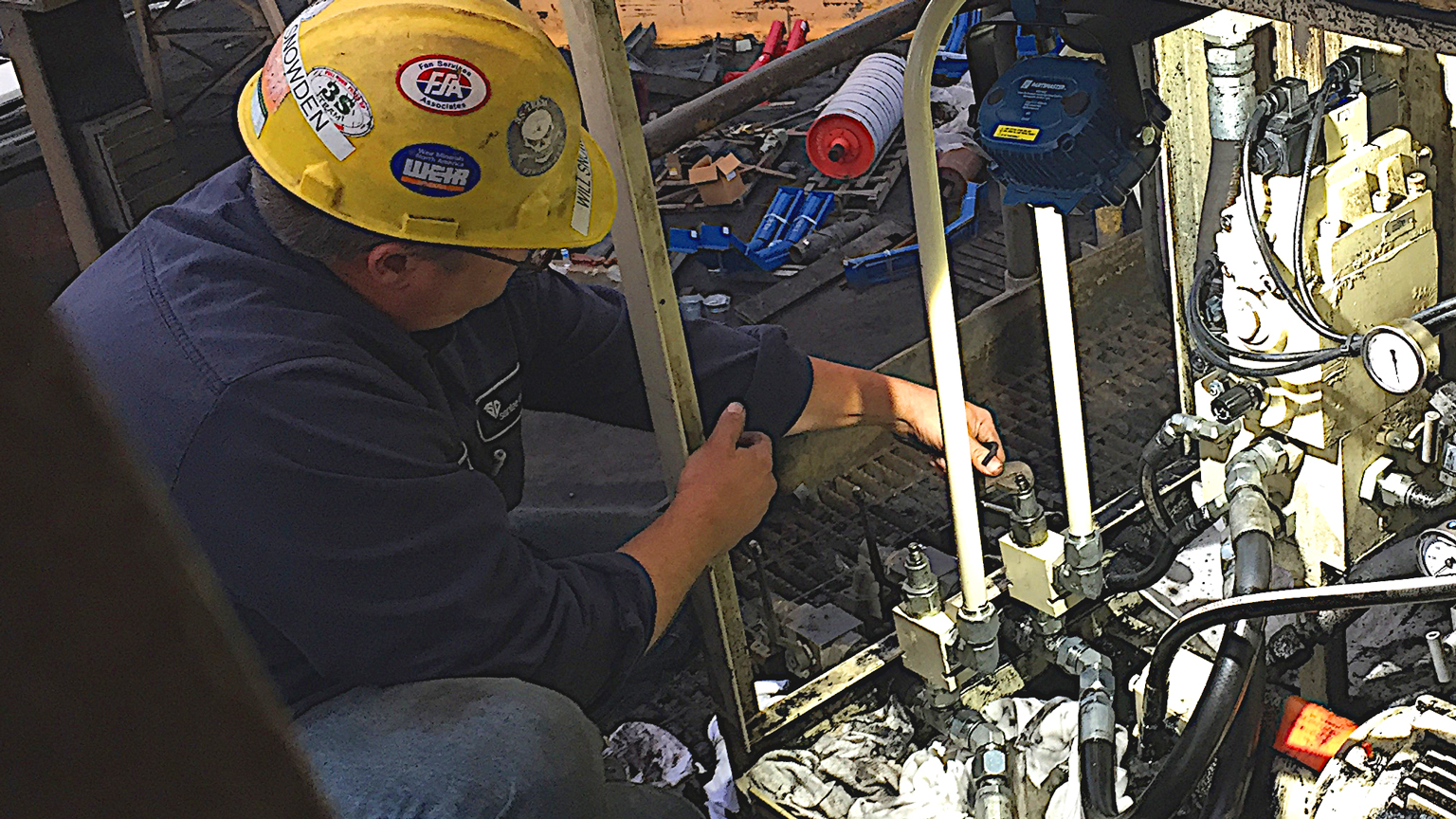

3. How to Troubleshoot Individual Components, Preferably Without Removing Them from the System
Suppose that, based on our knowledge of the function of the components and our ability to trace the flow on the schematic we determine that there are only, say, three components that could possibly cause the symptoms we are seeing? Why not just change all three of them and be finished with it?
This could sound like the most efficient path to take. After all, unscheduled downtime can run well into the five figures (and sometimes six figures!) depending upon the plant and specific machine. This can make the cost of a couple of unnecessary parts seem insignificant compared to the additional troubleshooting time. We have known many people to do exactly this in the interest of getting the system back online as quickly as possible. This is a mistake.
If we change multiple components, we don’t know which one corrected the issue. This is critical information if we wish to perform Root Cause Failure Analysis. Even beyond unnecessary parts cost and the inability to determine the root cause of the problem, the most important reason not to do this is the risk of contamination. Whenever a component is removed from the system, the lines are opened to airborne contaminants. Industrial plants are notorious for these contaminants, but even the cleanest of environments will have large enough particles to do damage. Microscopic particles much too small to see can wreak havoc with a hydraulic system. We could do everything correctly, follow all best practices and still contaminate the system, so we wouldn’t want to take the chance of removing it from the system, unless we had very good reason to believe that a component is bad.
Almost all components show specific symptoms when they fail. By using proper troubleshooting techniques, the worn component can be determined, usually quite quickly. While it is possible to repair the system by changing multiple components, it’s also possible to add a problem or two. Usually, by the time we are called to assist, a lot of parts changing has occurred. Often, what began as a relatively simple problem has escalated to multiple issues, much more difficult to diagnose.
