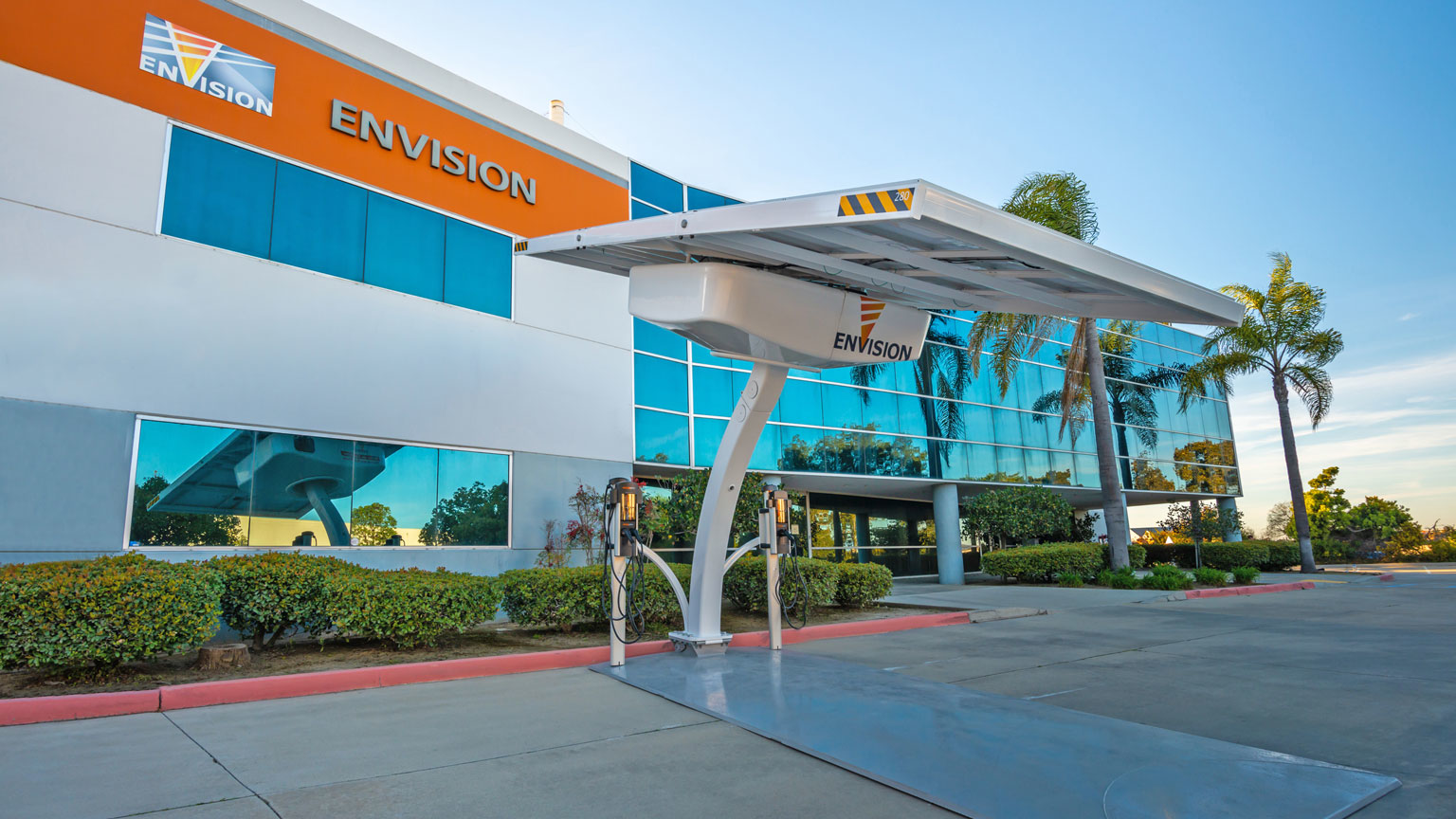

When our company Envision Solar decided to tackle the challenge, building what we called the Electric Vehicle Autonomous Renewable Charger or EV ARC 2020, we identified two major issues. The first was making sure it would operate in all climates and conditions. The second was ensuring it would operate at maximum efficiency while remaining simple and reliable.

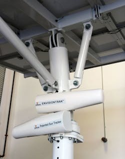

We soon settled on a simple and highly robust tracking solution that would provide almost all the gains with a far lower likelihood of failure. Our engineers devised simple but sufficient tracking algorithms to control the most reliable hardware in a patented EnvisionTrak solar tracker.
EnvisionTrak tilts the array to keep it aimed toward the sun. But rather than swinging or rolling the array, as is common with most tracking devices, we effectively bend the column atop which the array sits. This is vital for parking because while the column reorients the array, it constantly maintains the array’s alignment with the parking space no matter where the vehicle is pointed.
Swinging the array would have it encroaching on adjacent parking spaces, or worse, the driving lanes (which is illegal if it’s also a fire lane). The subsystem lets the panels generate 25% more electricity than a fixed array, and more electricity means miles driven or hours of equipment operation.

The EV ARC requires little space (just a parking space worth) and no construction at all. It is delivered to site, ready to operate and gets moved to the next job site as soon as it is no longer needed at the first. Because it generates and stores all its own electricity, it can charge at any time—not just when the sun is shining.
