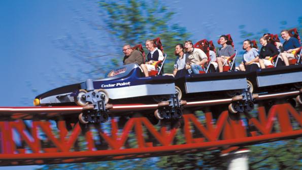

Gravity has pulled this coaster train down a 420-ft hill. A powerful hydraulic system launched it to the top.
